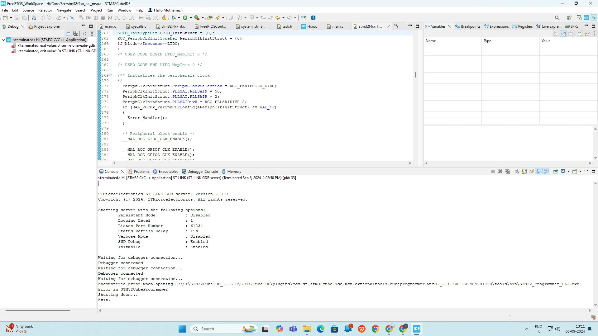

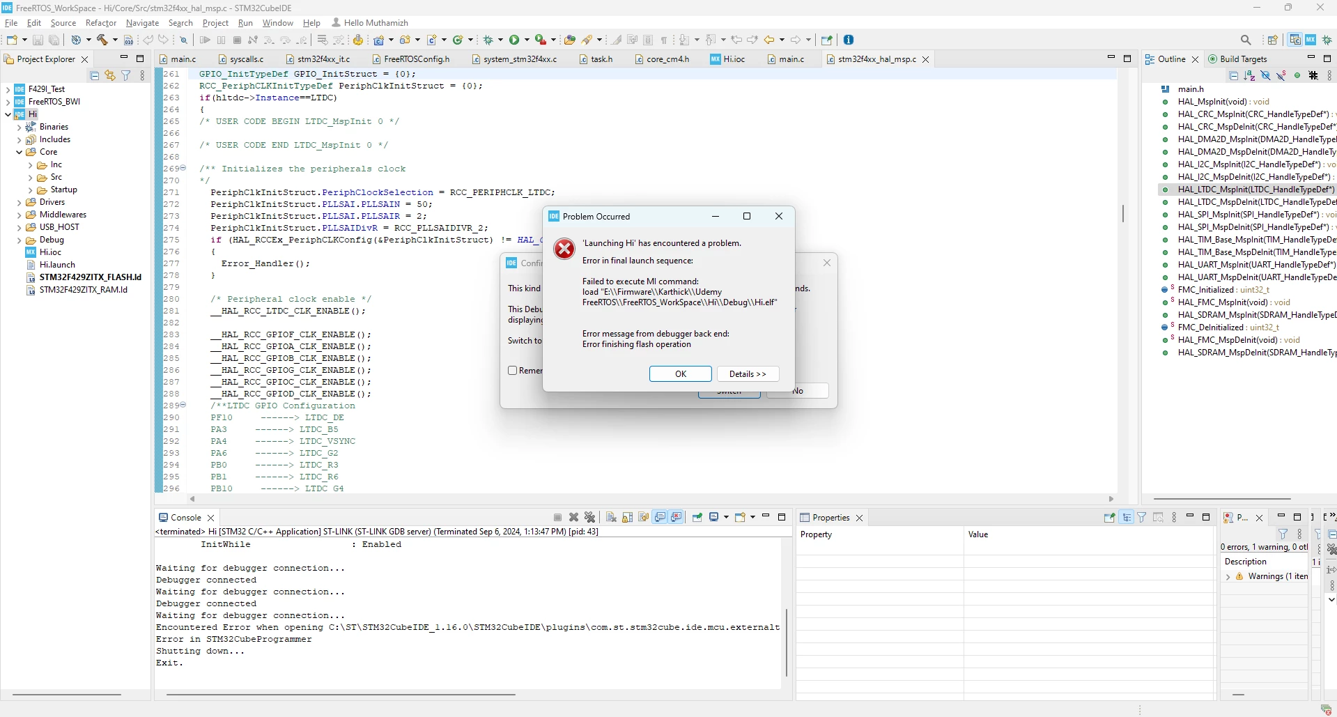

I am using the STM32F429I board using the stmcubeIDE i tried to load the program via st-link but it got ended with the above program.

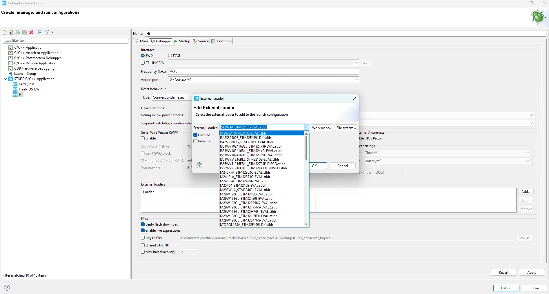

After that i tried the alternate steps by loading the external loader but i cant find the (.stldr) file in the external loader file list  i have attached the image below in that image the (.stldr) file for the stm32f429i was not found.
I need some help to tackle this problem. kindly respond to this if any of you find the solutions.

4 replies
mƎALLEm
mƎALLEmBest answer
September 6, 2024
Hello @Muthamizh and welcome to the community,
Try this loader:

Okay but i need better visibility to my problem i don't find any stldr file for my stm32f429i series.
could u please look into it to solve the issues.  :)
Note: I had also tried the solution u had suggested for this previously.
mƎALLEm
September 10, 2024
I used this Loader with STM32F429-EVAL board and it works well.
See my reply here: https://community.st.com/t5/stm32cubeide-mcus/debugging-issues-stm32f429i/td-p/718021
