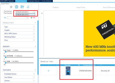

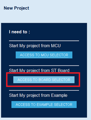

MuthamizhAuthor
Sep 11, 2024 5:04 AM UTC
My board series is STM32F429I-DISC1 does the STM32F429-EVAL &STM32F429I-DISC1 are different or both functionality and all other specs are same.
mƎALLEm
Sep 11, 2024 8:08 AM UTC
There is no EXTERNAL Loader for STM32F429I-DISC1.
Whey in the previous post you are looking for an external loader? I thought you are using an EVAL board.
MuthamizhAuthor
Sep 11, 2024 8:55 AM UTC
Okay how can I use IDE to work with this board do you have any idea.
