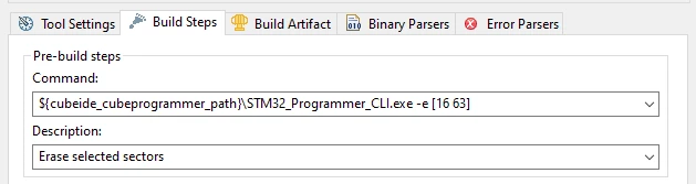

is it possible to add a command in the startup tab of the debug configuration, to erase a group of selected sectors, before programming?
For example I want to erase sectors [16..63], but not sectors [0..15].
I have only found the "monitor flash mass_erase" command, but it erase all flash.

    Hello @FBL,
    if I try to add the following pre-build step, as indicated in the post:
    STM32CubeProgrammer is launched correctly, but only dumps the cli usage syntax.
    make -j7 all
    C:\ST\STM32CubeIDE_1.11.2\STM32CubeIDE\plugins\com.st.stm32cube.ide.mcu.externaltools.cubeprogrammer.win32_2.0.500.202209151145\tools\bin/STM32_Programmer_CLI.exe
    STM32CubeProgrammer v2.12.0
    Usage :
    STM32_Programmer_CLI.exe [command_1] [Arguments_1][[command_2] [Arguments_2]...]
    Generic commands:
    -?, -h, --help : Show this help
    -c, --connect : Establish connection to the device
    However, if I append the command to erase selected sectors of flash
    I have the following error:
    make -j7 all
    C:\ST\STM32CubeIDE_1.11.2\STM32CubeIDE\plugins\com.st.stm32cube.ide.mcu.externaltools.cubeprogrammer.win32_2.0.500.202209151145\tools\bin\STM32_Programmer_CLI.exe -e [16 63]
    c:/st/stm32cubeide_1.11.2/stm32cubeide/plugins/com.st.stm32cube.ide.mcu.externaltools.make.win32_2.0.100.202202231230/tools/bin/sh: C:STSTM32CubeIDE_1.11.2STM32CubeIDEpluginscom.st.stm32cube.ide.mcu.externaltools.cubeprogrammer.win32_2.0.500.202209151145toolsbinSTM32_Programmer_CLI.exe: not found
    make[1]: *** [makefile:93: pre-build] Error 127
    make: *** [makefile:61: all] Error 2
    "make -j7 all" terminated with exit code 2. Build might be incomplete.
    What am I doing wrong?
    Thank you,
    Carlo

    Why if I launch STM32_Programmer_CLI.exe as a pre-build step, without command line options, it is launched correctly (but do nothing), and if I launch it with the desired command line options, like -e[16 63], I have an error saying that STM32_Programmer_CLI.exe is not found?

    Pavel A.
    October 6, 2023
    From the log above, the built-in "sh" utility (busybox) does not like backslashes. Try somehow to replace all \ to \\ or to / or use cmd in the command: cmd /c "${cubeide_programmer_path}\STM32_Programmer_CLI.exe -e [16 63] "

    Hello @Pavel A.,
    cmd /c "${cubeide_cubeprogrammer_path}\STM32_Programmer_CLI.exe -e [16 63]" seems to be the correct way to invoke STM32_Programmer_CLI.exe.
    Now the tool is launched, but it doesn't perform the erase operation because of the following error:
    cmd /c "C:\ST\STM32CubeIDE_1.11.2\STM32CubeIDE\plugins\com.st.stm32cube.ide.mcu.externaltools.cubeprogrammer.win32_2.0.500.202209151145\tools\bin//STM32_Programmer_CLI.exe -e [16 63]"
    make[1]: *** [makefile:93: pre-build] Error -1073741819
    Even if I don't know what this return code indicates (I cannot find a return code list in UM2237), I guess that one of the problems is that I need also to specify the connection port.
    So I have added the -c port=SWD option in the command line and now the erase operation seems to be performed correctly, as suggested by the output dumped on the console:
    make -j7 all
    cmd /c "C:\ST\STM32CubeIDE_1.11.2\STM32CubeIDE\plugins\com.st.stm32cube.ide.mcu.externaltools.cubeprogrammer.win32_2.0.500.202209151145\tools\bin\STM32_Programmer_CLI.exe -c port=SWD -e [16 63]"
    ST-LINK SN : 001D0008544B500520343637
    ST-LINK FW : V3J10M3B5S1
    Board : STLINK-V3SET
    Voltage : 3.28V
    SWD freq : 24000 KHz
    Connect mode: Normal
    Reset mode : Software reset
    Device ID : 0x460
    Revision ID : Rev B
    Device name : STM32G07x/STM32G08x
    Flash size : 128 KBytes
    Device type : MCU
    Device CPU : Cortex-M0+
    BL Version : 0xB2
    Debug in Low Power mode enabled
    Erase sector(s) ...
    Existing specified sectors are erased successfully
    Protected sectors are not erased
    Is it right?
    Regards,
    Carlo

    Looks much better. do you see the sectors actually erased with other tool such as CubeProgrammer GUI?
    CTabo.1
    CTabo.1Author
    Senior
    October 11, 2023
    Hello @Pavel A.,
    yes I have verified with CubeProgrammer that the sectors are actually erased.
