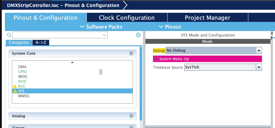

    Best answer by KMill
    OK Found it!
    Somehow I have set debug to "No Debug" - Must have been me, but I don't recall ever going there!
    Changing ti back to Serial Wire debug fixes it.

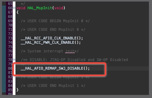

    @Andrew Neil Thanks for the suggestion.
    If I step into HAL_Init() it stops at this line:
    My IOC file has reserved the pins for debug:
    Andrew Neil
    September 25, 2024
    Look at the comment immediately above that line: you are disabling the JTAG and SWD - so obviously the debug connection will fail!
