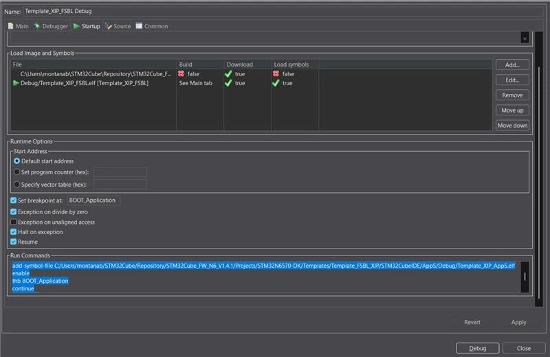

Hi guys,
This is what I’ve been using: make sure you have the external loader added, differently from most articles I contributed, we have to remove the *.elf and keep the signed binary and the FSBL:
On the gbd ru command, I’m using it like this, where the commands save the breakpoints you have, load the *.elf file, add the hardware breakpoint at a point where the external memory is already mapped, allowing the restore of the saved breakpoints:
set confirm off
save breakpoints breakpoints.gdb
delete breakpoints
add-symbol-file C:/Users/%username%/STM32Cube/Repository/STM32Cube_FW_N6_V1.4.1/Projects/STM32N6570-DK/Templates/Template_FSBL_XIP/STM32CubeIDE/AppS/Debug/Template_XIP_AppS.elf
enable
thb BOOT_Application
continue
commands
enable
source breakpoints.gdb
enable
Hope this helps
