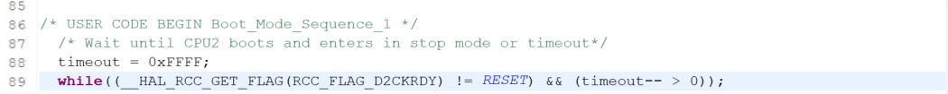

I configured adc+dma of h755 on cubemx and generated code for cube ide.
I compile (have not changed the code since it was created) and it's normal.
However, when debugging, it runs to this line and cannot exit.
H755 board is NUH755ZIQ$AT3, while I debug on NUH755ZIQ$AT1 and it's normal.
Thanks for any solution

my problem lies in the fact that it cannot escape while((__HAL_RCC_GET_FLAG(RCC_FLAG_D2CKRDY) != RESET) && (timeout-- > 0));
I looked at your suggestion but none of the solutions worked.

The solution is to load the code for CM4 first and reload the code for CM7 to solve this problem.
