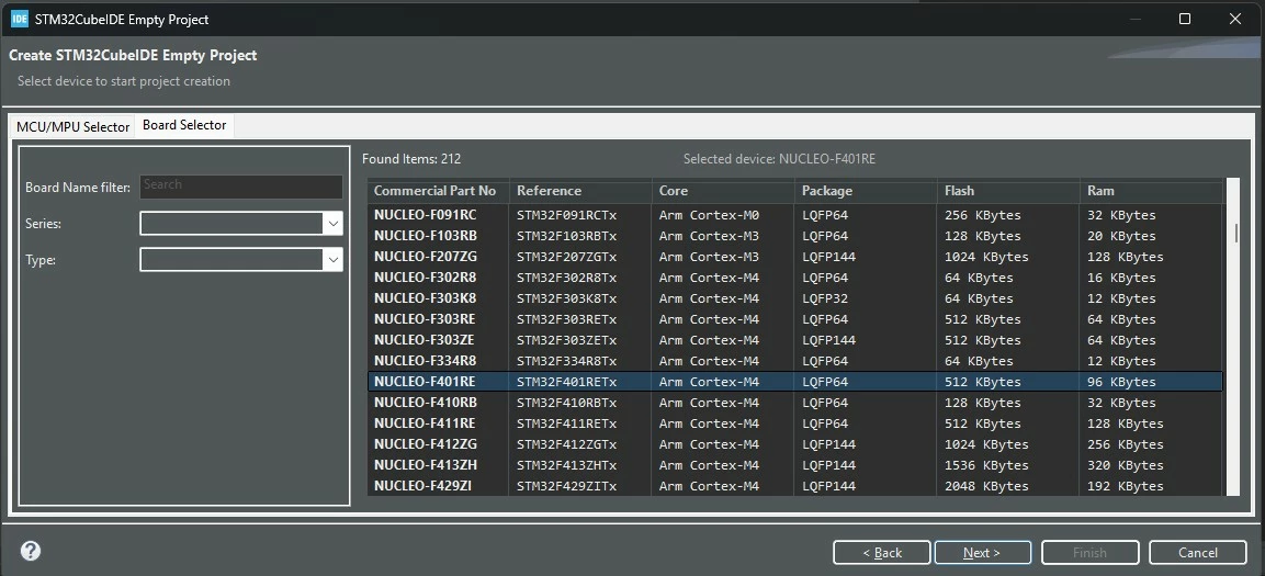

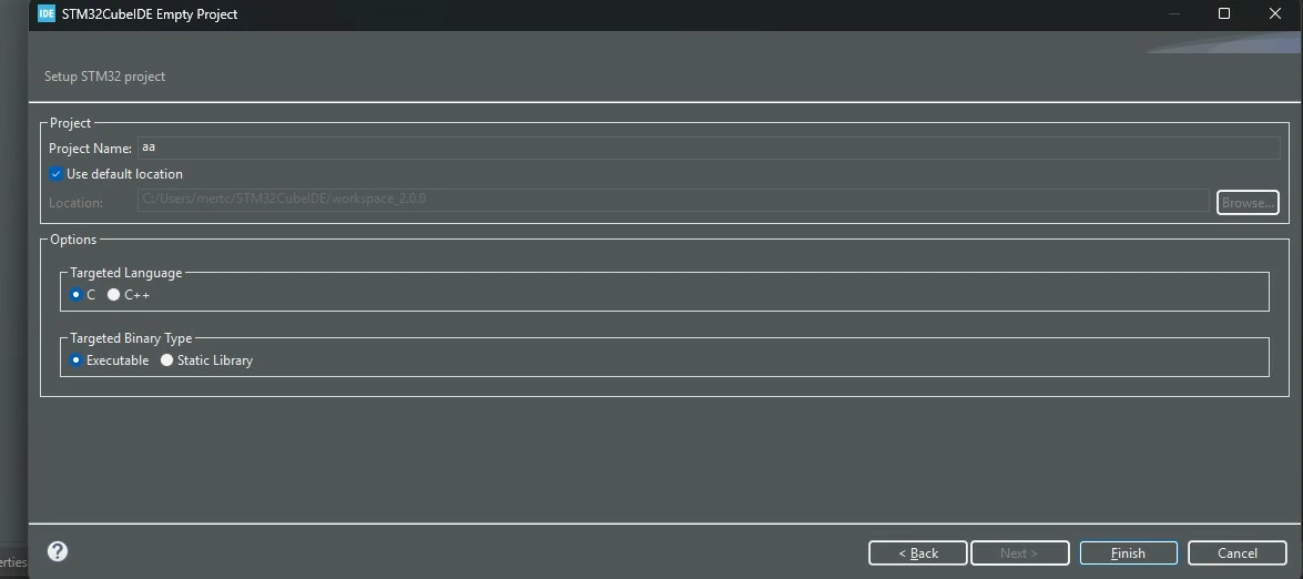

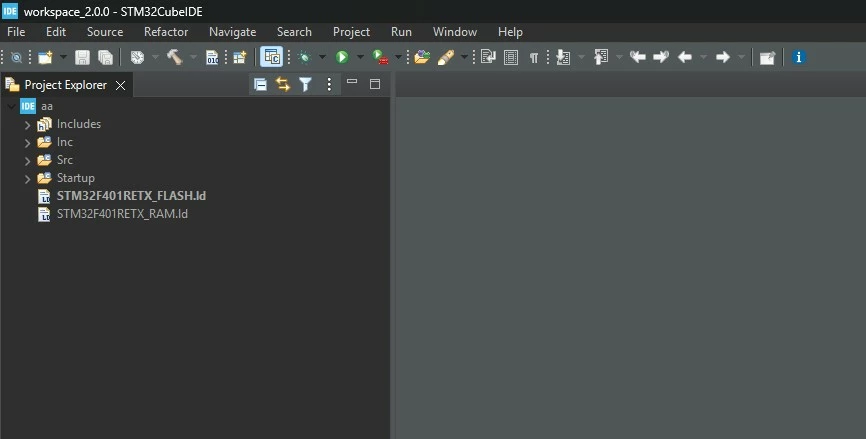

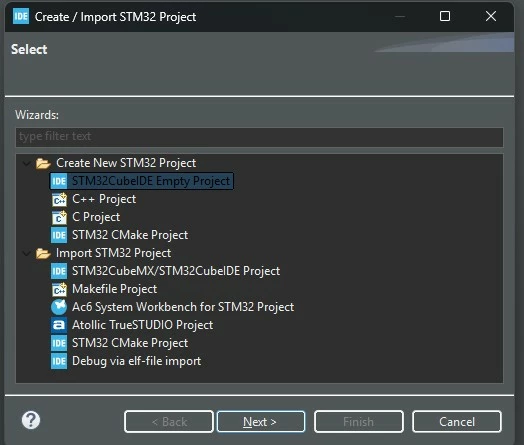

CubeIDE v2.0.0 does not create .ioc File
Today I have downloaded STM32IDE. I am trying to develop some projects with my NUCLEO F401RE. I have tried that create a new file from this way but program does not create any .ioc file. Can you help me?
Thank you.

Andrew Neil
Feb 2, 2026 12:37 PM UTC
CubeIDE v2.0.0 no longer has CubeMX integrated - you now have to use it as a separate, standalone app.
See: STM32CubeIDE 2.0.0 New workflow tutorial.
See also: STM32CubeIDE 2.0.0 released
For discussion of the rationale behind this, see:IDE Version 2.0.0 - why remove MX ?
