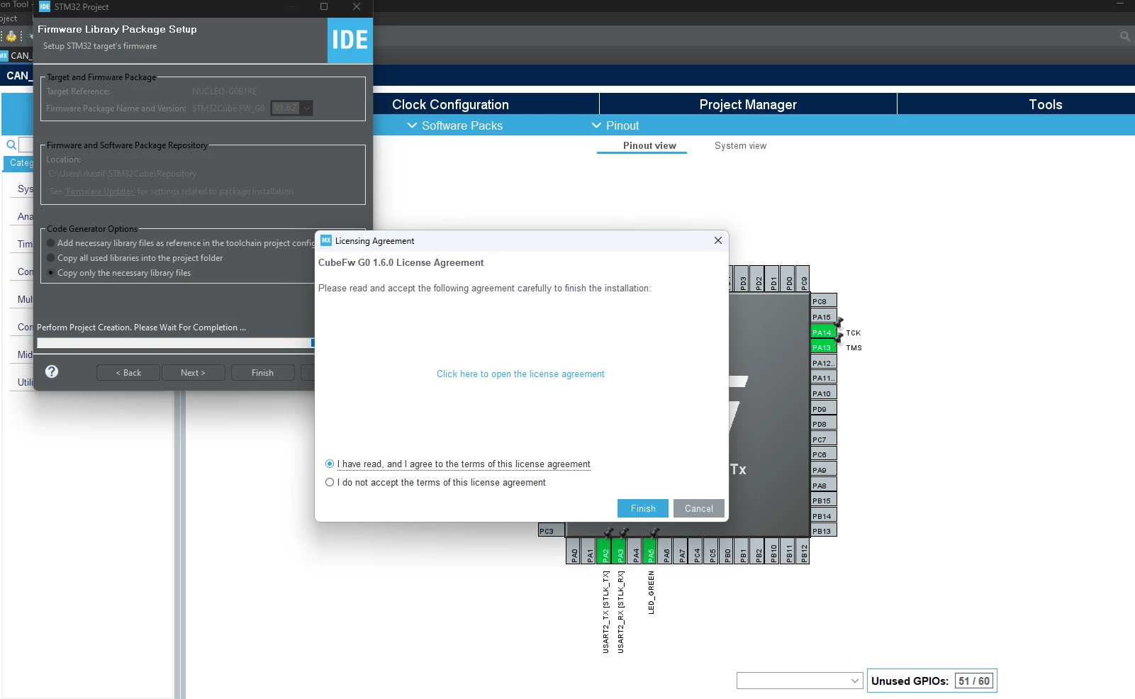

CubeIDE issue related to stm32G0 package - IDE goes to be uninstalled
Hello,  I wanted to create new project in CubeIDE (1.13.2, 1.17.0) for STM32G0B1RE but there is some bug after confirmation of licence. CubeIDE is getting close and uninstall from windows, too. That's crazy behavior. Is there some general problem with pack for stm32G0? The configuration is not possible to generte for this, only *.ioc file exist in project.

@RKast.1 wrote:
CubeIDE is getting ... uninstall from windows, too. That's crazy behavior.
Yes, it certainly would be!
How do you determine that it's been uninstalled?

Ah, sorry, the problem was on my side. My antivirus blocked some process of CubeIDE at stm32G0 package update and this information was hiden for me. And it removed only exe file, not installation.
Sorry for this task, all is OK now...
