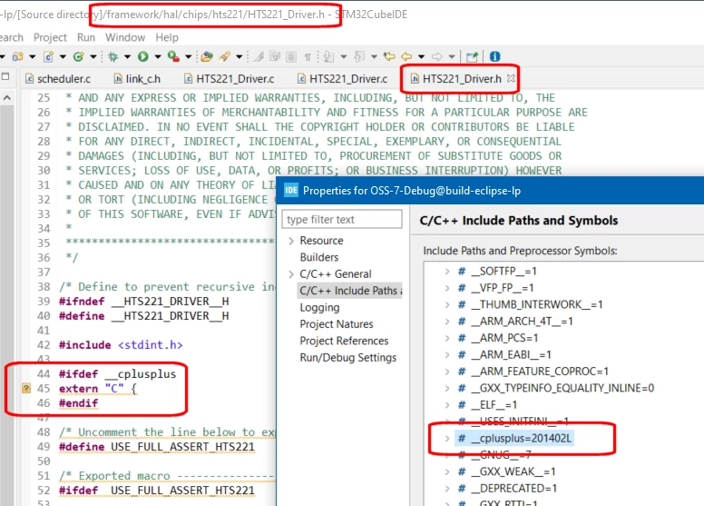

CubeIDE: Imported Eclipse 'C' Project incorrectly defines __cplusplus
STM32 CubeIDE v1.5.1; Build: 9029_20201210_1234 (UTC)
The same Eclipse Project as:
https://community.st.com/s/question/0D53W00000Y2lIsSAJ/cant-usecreate-debug-config-for-oss7-stack
It is a 'C' Project, but the CubeIDE defines __cplusplus:
Which, as you can see, messes-up the codes checks to see if C++ is being used!
If I manually delete that definition, all is fine.
The problem does not happen when opening the project in a "normal" Eclipse Neon 3.
So why is CubeIDE adding this?

Q1: If you open the .project-file in the original project (before importing it into CubeIDE). Does it contain the node: <nature>org.eclipse.cdt.core.ccnature</nature> ??
  • cnature is only C project
  • ccnature is a C/C++ project
Q2: If you import the project into CubeIDE. Now open the .project-file, does it now contain the ccnature node?
If CubeIDE for some reason adds C++ to the project file, then it sounds like a bug. If it is part of the original content, then I would guess this is expected?!
If ccnature. then the C++ compiler is also setup for the project, and then the C++ compiler would set up the symbol "__cplusplus=201402L", assuming you are using -std=gnu++14.
Need som more info/answers...

OK, the freshly-created Eclipse Project contains:
	<natures>
		<nature>org.eclipse.cdt.make.core.makeNature</nature>
		<nature>org.eclipse.cdt.make.core.ScannerConfigNature</nature>
		<nature>org.eclipse.cdt.core.cnature</nature>
	</natures>
So, yes: it does contain a "ccnature" - and also a "cnature"
I just opened this in CubeIDE by double-clicking the .project - and this time it has not defined __cplusplus !

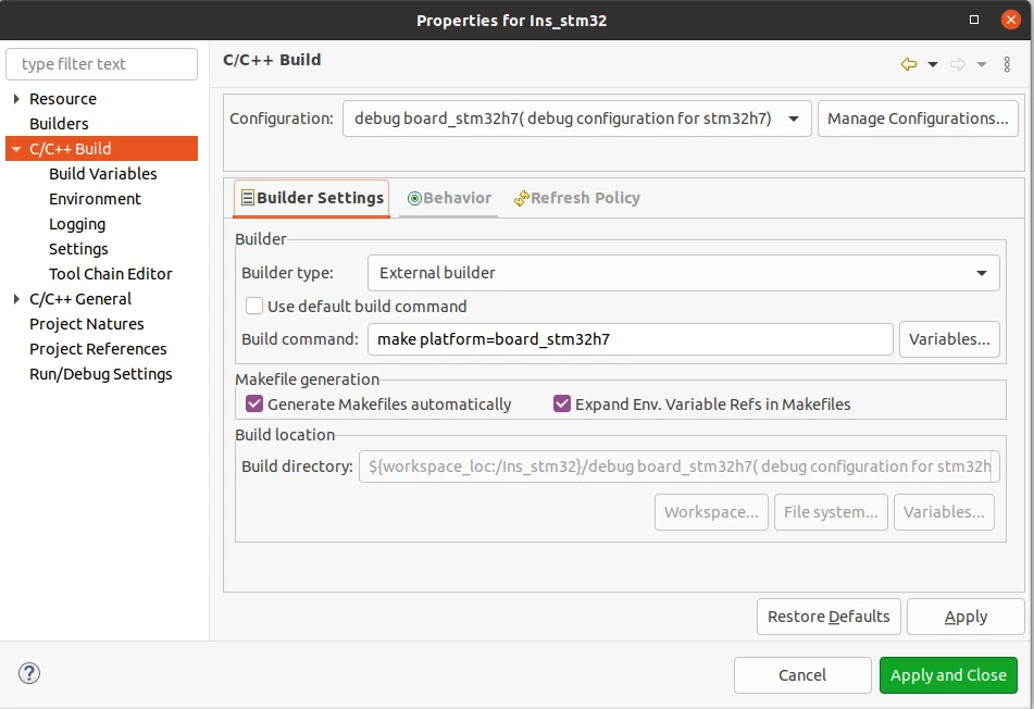

Then try this:
  1. File > New > Makefile project with Existing Code
    1. Give a name
    2. Point to the project location
    3. Select MCU ARM GCC
  2. OK - you will now have to make sure that the makefile is found by the build system.
    1. Hint, check: Project Properties > C/C++ Build > Builder Settings > Build directory
  3. Once you have a working makefile you probably want to debug as well...

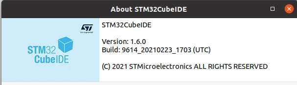

  4. To make debug work the debugger integration needs to know which MCU you are targeting. Because of a known issue in CubeIDE 1.6.0, you have to perform a little stunt:
    1. Project Properties > C/C++ Build > Builder Settings > Check "Generate Makefiles automatically".
    2. Click Apply
    3. WARNING: Do NOT build your project until step 7 is finished!! If you do, the managed build system will overwrite your makefiles!
    4. This will expose a hidden GUI:
    5. Project Properties > C/C++ Build > Settings > Tool Settings > MCU Settings > Select.
      1. Browse for your MCU select it and click Apply.
    6. Go back to Project Properties > C/C++ Build > Builder Settings > and Uncheck "Generate Makefiles automatically".
    7. Click Apply.
  5. All done. If you create a debug config now you should be able to debug the target... If you instead tried to launch the debug session without performing step 4 you will get tons of errors messages...

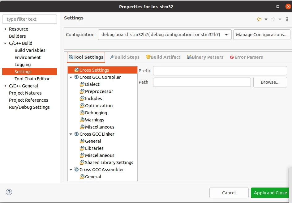

Pavel A.
Mar 2, 2021 5:14 PM UTC
Hi @mattias norlander​
Your advise unfortunately does not work here on Ubuntu...
We have an existing makefile project.
Checked "Generate Makefiles automatically".
But this does not enable " MCU Settings"
0693W000007ZvQOQA0.pngPlease advise ? Is this working only on Windows or only for newly created makefile projects?

Pavel A.
Mar 3, 2021 2:32 AM UTC
Answering my own question...
* The trick to specify the MCU requires to create a new CubeIDE makefile project, as in the Mattias' post above.
* Folks who have any other Eclipse makefile - based projects, can take them and *** **** up their *** ****.
* The binary should be located under the project directory. Could not make the GUI recognize any build variables or linked resource paths to specify the binary to debug.
Anyway this is definitely a progress.
Thanks!
-- pa

@mattias norlander​ : "To make debug work the debugger integration needs to know which MCU you are targeting. Because of a known issue in CubeIDE 1.6.0, you have to perform a little stunt" (March 4, 2021 at 3:30 PM)
We're now up to CubeIDE v1.7.0 - is the "little stunt" still required ?
mattias norlander
Oct 25, 2021 1:40 PM UTC
Hi Andrew,
Yes, unfortunately the stunt will still remain required.
There is no easy way to get rid of "the little stunt" without making more substantial changes.
Those changes are not justified by the moderate usage numbers we see related to CDT projects.
Kind regards, Mattias
