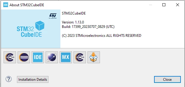

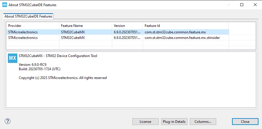

Today I tried migrating our projects to the new STM32CubeIDE release. One thing I noticed is that whenever MPU is enabled, it generates redundant function prototype
static void MPU_Initialize(void);
in main.c which generates a warning when -Wall is enabled. This function is not even implemented, it seems that only
MPU_Config();
is called. Steps to reproduce: it is enough to create a new project (I tried for STM32H723VG MCU), enable MPU and this prototype is generated. Here is the build info:
I think it is a bug in the code generation.

    Hello @heveskar
    First thank you for posting and mentioning this behavior.
    In fact, in this context the "static void MPU_Initialize(void);" prototype should not be called as this function is generated for other purposes.
    The temporary solution is to delete it from the code and this will not have any impact on it.
    With this been said, the problem is raised internally to be reviewed. I'll keep you posted with the updates. Internal ticket number: 157046 (This is an internal tracking number and is not accessible or usable by customers).
