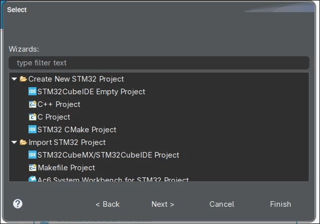

Hi, I have a problem with my CubeIDE installation that is that I cannot create a stm32 project(the option that integrates with CubeMX) I can only create the following
I've installed it from the shell script from the generic Linux download, I'm using arch Linux(btw).

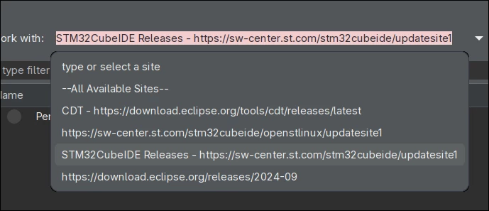

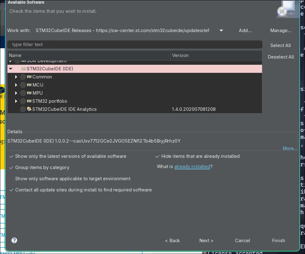

I've reinstalled it at least 3 times now, also went to Help -> Install New Software, used this site:
And installed everything down the STM32CubeIDE section.

CubeMX is no longer integrated into STM32CubeIDE. To create a new project, download, install and use the standalone STM32CubeMX application.

As @TDK  said, It's intentional: CubeIDE no longer integrates the MX functionality - it's now only available in the separate, standalone application.
Discussion about this here: IDE Version 2.0.0 - why remove MX ?
