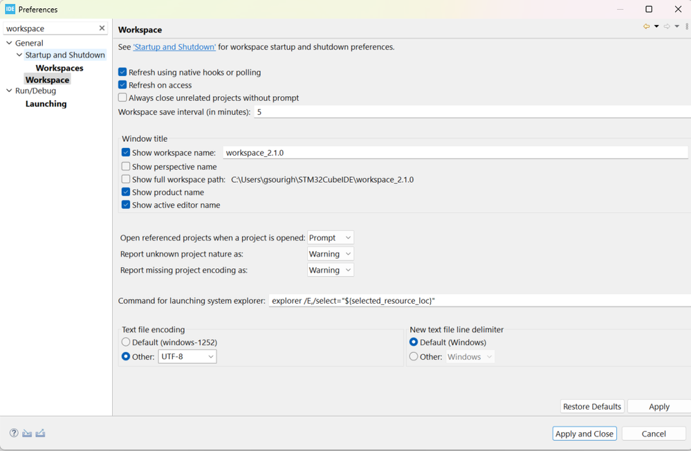

I've just installed the new STM32CubeIDE 2.1.0 and I came across some issues that didn't exist in previous versions.
First, I noticed that the compiler always compiles all the source files even though only one source file was modified.
I have large project with many source files and it takes about 2 minutes to compile all files. It's very annoying.
Second, when launchinig debug session all the source files are compiled again. It didn't work that way in previous versions of STM32CubeIDE. If the files were compiled previously, the debug session was launched immediately.
Is it possible to change this behavior but turning off some options or do I have to install older version of STM32CubeIDE ?

Hello all ,
Thank you @vaualbus for your help .
@kekon could you please try to disable the option "Refresh and poll using native hook" as suggested?
You can find this option under Window → Preferences. In the search field, type "workspace".
I will be waiting for your feedback .
THX
Ghofrane

As I answered in the other post, I found that disabling "Refresh and poll using native hook" in workspace settings, make the problem go away.
After the update I got this option enabled by default.
I was suggested to turn this on to get better performance in last releases but saw the issue and revert back by disable it.

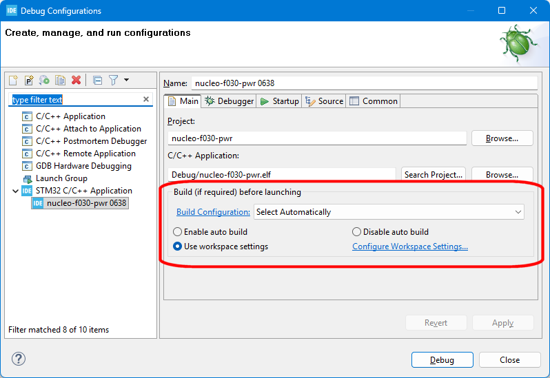

The default Debug behaviour is to do a build before download/debug - so this is actually just the same problem again.
As a workaround, you can disable this build in the Debug Configuration:
kekonAuthor
March 2, 2026
I tried changing the options in the "Build (if required) before launching" panel but it doesn't work.
I installed previous version (2.0.0) and it turns out that this version also works the same wrong way - it seems that 2.1.0 version screwed up some global settings of the CubeIDE that are used by all versions.
