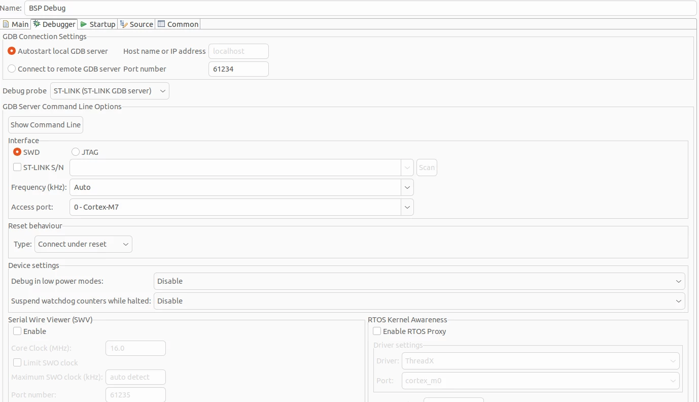

We are trying to evaluate the STM32H735IG for our product. We bought the off-the-shelf dev kit and tried flashing it using S32CubeIDE, but encountered an error. The weird thing is, I can use S32 programmer to read flash, so the ST-Link seems to be up-to-date. I feel there is something wrong with S32CubeIDE. Can you please help.
All the versions are below and also some screenshots to assist help debugging
STM32CubeIDE
Version: 1.14.0
Build: 19471_20231121_1200 (UTC)
OS: Linux, v.6.5.0-27-generic, x86_64 / gtk 3.24.33
Java vendor: Eclipse Adoptium
Java runtime version: 17.0.8.1+1
Java version: 17.0.8.1
Logs in the error window
Error in final launch sequence:
Failed to execute MI command:
load /home/STM32CubeIDE/workspace_1.14.0/BSP/STM32CubeIDE/Debug/BSP.elf
Error message from debugger back end:
Load failed
Load failed
Load failed
Load failed
Logs in the console
STMicroelectronics ST-LINK GDB server. Version 7.5.0
Copyright (c) 2023, STMicroelectronics. All rights reserved.
Starting server with the following options:
Persistent Mode : Disabled
Logging Level : 1
Listen Port Number : 61234
Status Refresh Delay : 15s
Verbose Mode : Disabled
SWD Debug : Enabled
InitWhile : Enabled
Waiting for debugger connection...
Debugger connected
Debugger connected
Shutting down...
Exit.

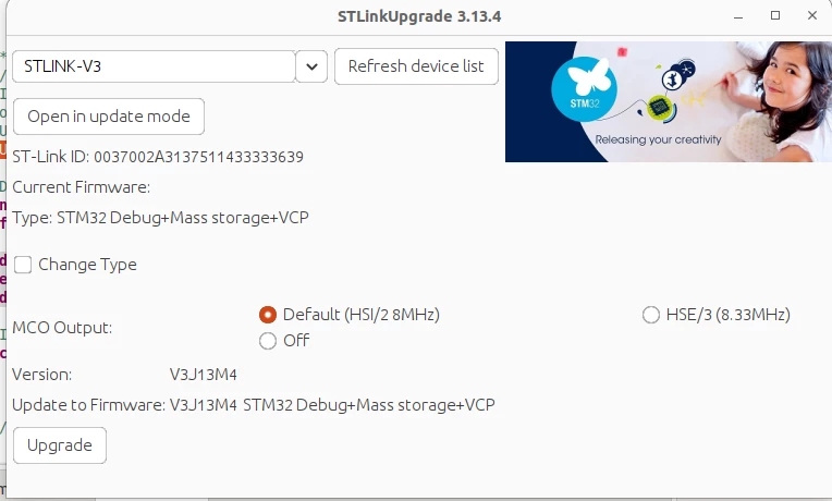

    Still the same. I upgraded Stlink to the latest version too

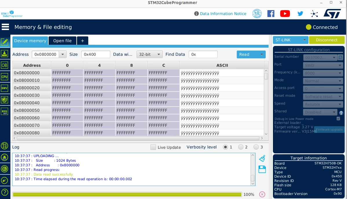

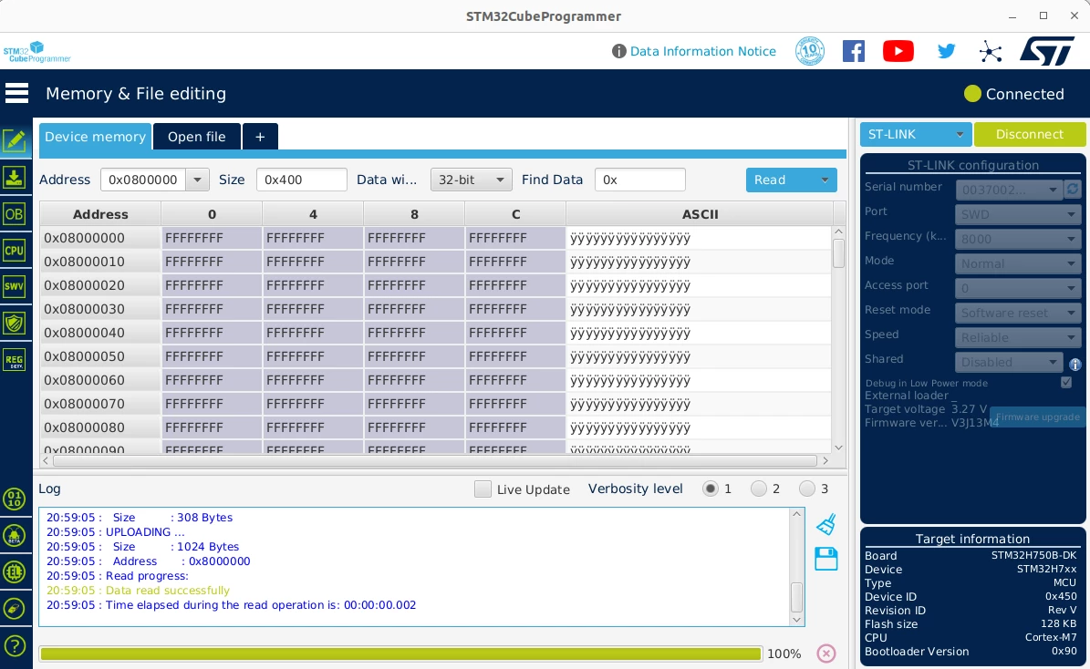

    May 22, 2024
    Can still erase via stm32cubeprogrammer attaching a screenshotScreenshot from 2024-05-22 10-38-12.png

    Hello We are trying the flash the sample off the example called BSP which blinks led.I don't see why this would affect connecting to stlink. Also many folks have experienced this problem but there is not concrete solutions.
    May 23, 2024
    Also tried @mattias norlander  solution in https://community.st.com/t5/stm32cubeide-mcus/how-can-i-remove-error-like-waiting-for-debugger-connection/td-p/250559 to include  debug configuration > Startup tab > Initialization commands > Add: monitor flash mass_erase in the startup script. The Mass erase is successful then it shuts down connection
