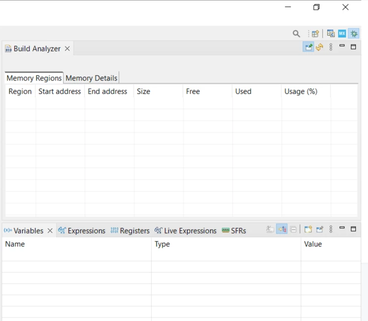

Build Analyzer not working with version 1.15.0 and 1.15.1
I am trying to see where the memory is being allocated, although there is no information being given after building the project.
I have already followed this solution:
https://community.st.com/t5/stm32cubeide-mcus/build-analyzer-does-not-work-after-stm32cubeide-update/td-p/652218
,but still no luck.

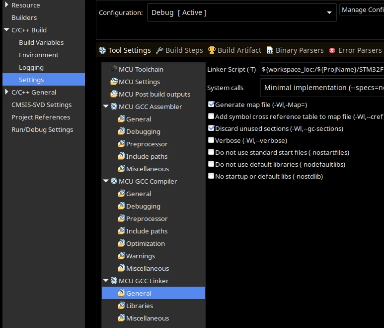

As well, I have followed this example:
To fix this permanently, you need to have your .map file name similar to your .elf file name.
In your example,
elf file name = STM32L476RG_NUCLEO.elf
map file name = ST_test.map
You can force your .map file name to STM32L476RG_NUCLEO.map by following these steps:
  1. Go to Properties>>C/C++ Build >> Settings >> Tool Settings >> MCU GCC Linker >> Miscellaneous
  2. Add the following flag: -Wl,-Map=STM32L476RG_NUCLEO.map
from https://forum.digikey.com/t/utilizing-the-build-analyzer-in-stm32cubeide/3882
I'm unsure if this is a specific issue with the newer versions of the IDE, but I will continue to try older versions of the IDE until I find one that works.

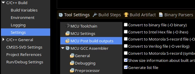

    AScha.3
    check : generate map file.
    show size + list file
    here from IDE 1.13.1 ; or 1.14.1 - same.

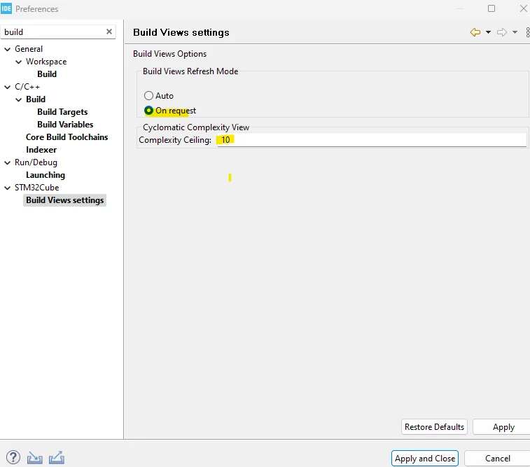

    Rim LANDOLSI
    Hello @Gianni7315 ,
    Could you try selecting the 'On request' option in the Build Views Settings. Then refresh the Build Analyser view using the 'Refresh' button, wait a while and the information will be displayed.
    Thanks,
    Rim
