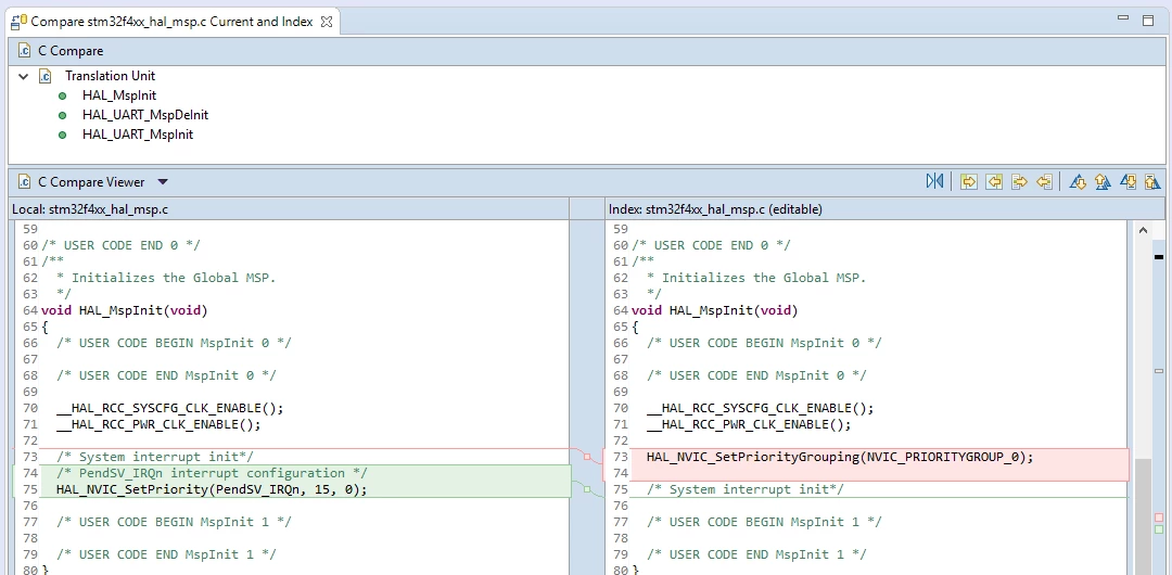

Issue is:

Hello @Daniel Mårtensson​
Tested the same scenario by using the last version of STM32CubeIDE (V 1.4.0), i had no issue.
Please try with this version then tell me the result,
Best regards,
Nesrine
DMårtAuthor
Lead
July 28, 2020
Hi! I tested​ with 1.4.0. Did not work.
I​'m using Linux Generic Installer on Lubuntu 20.04.
Look above. Somebody pos​ted an issue.
STM32MP151AAC3 custom board with STM32-OS as operating system: https://github.com/DanielMartensson/STM32-ComputerSTM32MP257FAK3 custom board with STM64-OS as operating system: https://github.com/DanielMartensson/STM64-Computer
Thanks for the feedback, issue reported to the tool development team that will plan the correction.

A new STM32CubeMX release will delivered to correct this issue as soon as possible.

I have worked on Win10, STM32CubeIDE Ver. 1.4 , and Nucleo-F401.
It is very strange to see this HardFault_Handler() error over PC in office but PC in home. Of course, I have used same version of STM32CubeIDE in two places. From a few days ago, it has made a HardFault error in office PC. I can see this error whenever I used FreeRTOS only, and I have no problem if I did not use FreeRTOS.

Hello @JChoi.4​
Yes! the problem appears only when you activate FreeRTOS.

In this morning, I found a cause of the problem.
I realized that STM32CubeIDE Ver. 1.4 might made HardFault_Handler() error with FreeRTOS, but Ver.1.3 did not this. I guess Ver. 1.4 got a problem. Anybody who got a problem with using a Ver. 1.4 for FreeRTOS do a down-grading to Ver. 1.3, you can enjoy a programming without the fear of HardFault_Handler() error.
