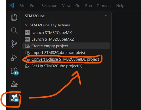

We have a project which uses STM32CubeIDE (Eclipsed-based). It has a Makefile which we use to compile the code and upload the code to the target. Since I know ST has made a new STM32CubeIDE VSCode extension, I wanted to have a trial to see if I can convert the existing Eclipsed based project to VSCode based project. I installed the STM32CubeIDE extension in VSCode and other necessary components. I followed the migration guide to generate a CMake project using STM32CubeMX. However, it never worked since the new CMake file doesn’t take what the original Makefile does in my project. It missed a lot of compiler and scripting options. After the migration, the build process failed and never succeeds. Since Makefile works great in the original project (either in CLI/GUI mode), why does the migration require user to convert it to CMake? Many Unix/Linux users prefer Make instead of cmake. It gives you better control over the source code. I would suggest ST that if you really want to make a VSCode extension for ST developers, you should support Makefile as the default toolchain, not cmake.

Such said, myself I’ve success converting Eclipse based project to CMake Thanks STM32CubeIDE for Visual Studio Code dedicated feature:
Have you got a try ?

I just tried another time using STM32CubeIDE VSCode extension “Convert Eclipse STM32CubeIDE project” menu. It still failed.  The error log shows that. My target MCU is STM32F7. My Makefile is a standard GNU Makefile with some STM32 linkerscript. There are some OpenOCD scripts for flashing target in Makefile.
2026-10-06 09:55:05.869 [Info] [ide-project-convert] Starting project conversion...
2026-10-06 09:55:06.631 [Info] [ide-project-convert]  cube wrapper version: 0.10.4
2026-10-06 09:55:07.449 [Info] [ide-project-convert] Invoking STM32CubeIDE Eclipse exporter...
2026-10-06 09:55:17.843 [Info] [ide-project-convert] Generating project...
2026-10-06 09:55:18.973 [Error] [ide-project-convert] Inconsistent source files found across project configurations is not supported.
2026-10-06 09:55:19.004 [Error]  [ide-project-convert]: Project conversion failed with exit code: 43.

Issue is self explicit. You’re facing an unsupported project setup.
Could you have a try - doing first a copy or source control of your project - to keep a single build configuration prior exercising the conversion process ?
Most probably you’ve extra sources as part of a Debug configuration compared a Release one or something like. Sounds not supported for now at least.

Thanks for your suggestions. I tried your approach but still didn’t work. So I’m not going to spend any time in converting this project since I have spent several days trying to figure it out without success. I’m happy with my Makefile setup since it just works. I’m curious if STM32CubeIDE VSCode extension supports Makefile project (not CMake). Right now, if I use VSCode without STM32CubeIDE extension, it works fine for code build and code navigation, but I can’t do debugging.

As ​@Cartu38 OpenDev stated earlier, the Inconsistent source files found across project configurations is not supported. error message means that your STM32CubeIDE project has several build configurations (maybe Debug and Release), but all configurations are not using the exact same set of source files. This is a known limitation, which hopefully will be addressed in the future.
To confirm this, could you check or share (here or by PM) the stm32cubeide-export.json file which should be produced into the destination folder?
