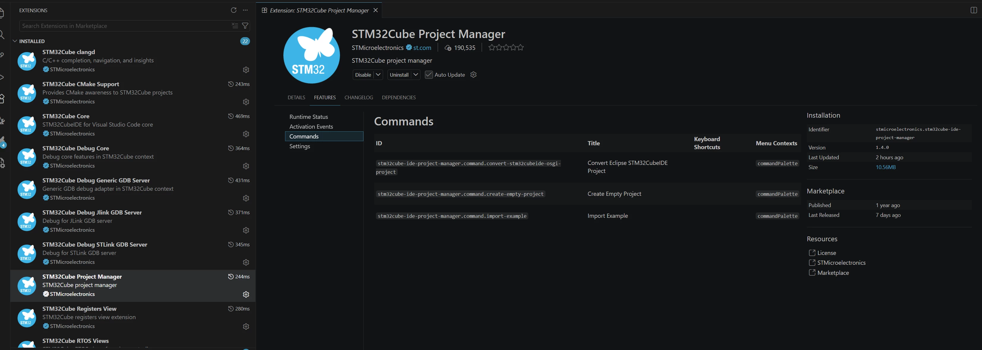

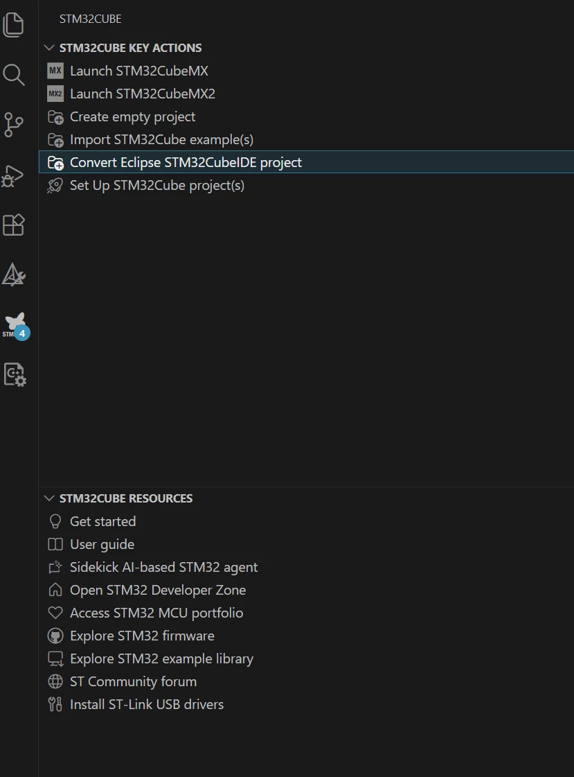

I’m using the “Convert Eclipse Stm32CubeIDE project” command that appears to be part of the STM32Cube Project Manager Extension Pack.
And that looks like it was updated 2 hours ago. And the problem persists, just tried it again. I’ll send those files to you via private message.

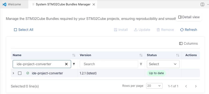

Sorry I had not been precise enough, the ide-project-converter is a bundle, so installed aside vscode extensions.
You can check its version using the bundle manager, system view:
ad101Author
Jul 27, 2026 2:33 PM UTC
Hi Julien,
Ah I see, yeah, the ide-project-converter bundle was on 1.1.1, I believe. Unfortunately, even after updating to 1.2.1, the issue persists.

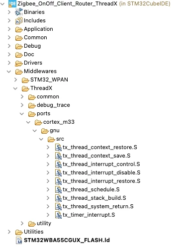

What looks strange at that stage is the fact that apparently the threadx sources are located outside of the STM32CubeIDE project tree, and ../Middlewares/ST/threadx/ports/cortex_m33/gnu/src seems never be referenced. Means I don’t explain how they can be built in STM32CubeIDE neither.

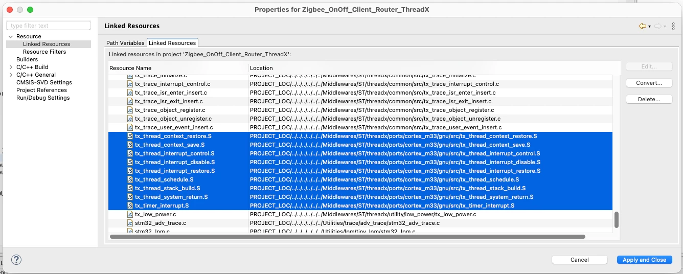

Usually external sources are referenced as Linked Resources from STM32CubeIDE project, and in your case I don’t see any trace of such.
Here is a screenshot using a random cortex m33 threadx example from FW package (STM32Cube_FW_WBA_V1.8.0/Projects/NUCLEO-WBA55CG/Applications/Zigbee/Zigbee_OnOff_Client_Router_ThreadX/STM32CubeIDE)
The icons show they are Linked Resources, also visible from project properties:

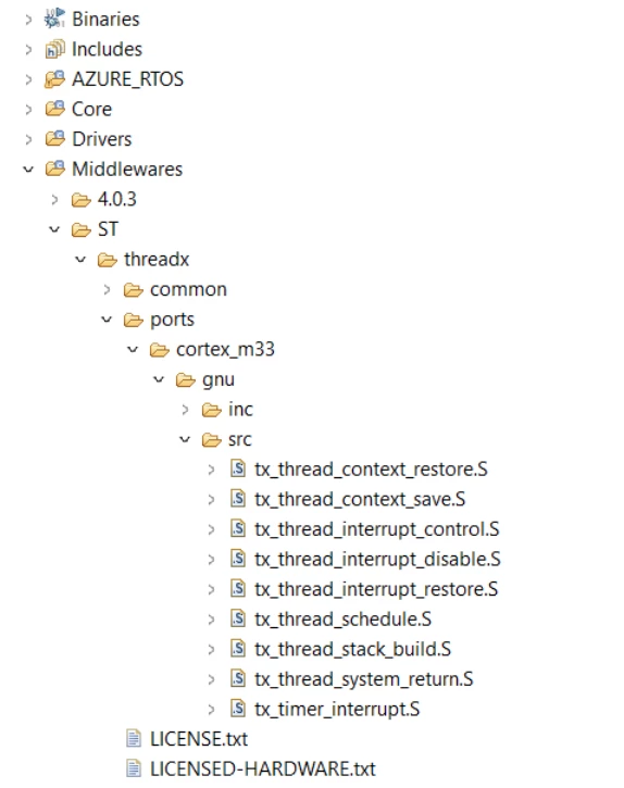

And I believe the threadx assembly files should be part of the project tree:
So I guess it’s just some niche bug then? I didn’t create the project, so I don’t know if there was anything unique about the creation process.

Thanks ​@ad101, for your screenshot. It helped a lot in understanding the root cause.
This is only a matter of file extension: the exporter considers only .s files as assembler sources, not .S files.
You can confirm this on your side by simply renaming the assembly sources to *.s.
