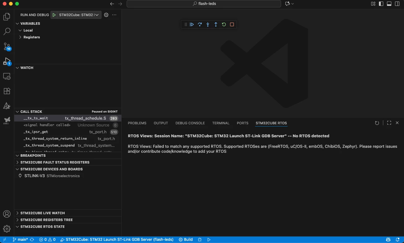

You mention threadx in the Enhanced RTOS debug section. When I select STM32CUBE RTOS tab It is unable to detect the threadx RTOS. Should I be able to see details of threadx in this tab. It does not list threadx in supported RTOSs. Do I need to enable something in build to see RTOS debug?
Sep 30, 2025 4:30 PM UTC
@macfai2,
For ThreadX, `STM32Cube RTOS` is not helpful.
Please consider the view you have in the left panel. The `STM32Cube RTOS state` supports both ThreadX and FreeRTOS.
We apologize for the current split experience; we are working on improving it.
Please note, to use the STM32Cube RTOS state view, you need to add some extra directives to your launch.json. You can rely on the editor's auto-completion by trying to type `rtos`.
