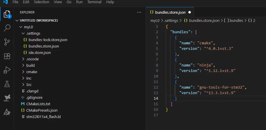

My bundles.store.json looks like this:
 "bundles": [
 "name": "st-arm-clangd",
 "version": "^19.1.2+st.3"
 "name": "gnu-tools-for-stm32",
 "version": "^13.3.1+st.8"
 "name": "stlink-gdbserver",
 "version": "7.10.0+st.3"
(I installed ninja using my OS package manager because the STM32 VSCode extension also couldn't find its own ninja installation.  There's probably a way to fix that too but I didn't pursue it because installing my own ninja was an easier solution.  I also have cmake already installed on my system.)

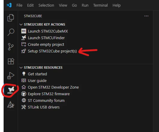

On my computer, "Setup STM32Cube project(s)" is shown but it is grayed out.  I'm not sure what that means.  I don't have STM32Cube stuff installed separately.  I only installed the STM32 VSCode extension and the system bundles shown above.  We're not supposed to install Cube outside of that process, are we?

Much of that tutorial is out of date and incorrect for v3 of the extension.  For example, there is no STM32CubeCLT anymore (the extension brings its own toolchain as a "bundle").  And there is no longer any place in the extension settings to configure paths.
My impression is that the VSCode extension is trying to be self-sufficient.  Obviously you will run CubeMX for things like pin planning, and code generation if using HAL, but you are never prompted to run it when creating a blank project, at least in the latest prerelease (v3).

vincent_grenetBest answer

@mark03 your shared bundles.store.json looks promising but is not complete. You should get as extra from early begining cmake & ninja as part of.

Having as expected cmake & ninja as part of your bundles.store.json you should be able to run the following commands:
cube cmake --version
cube ninja --version
.. getting as result proof these tools are set and starting to get you understand based on bundles.store.json (project based so) you could get version of tool(s) you want per project.
Based on your bundles.store.json the following should give some results the same:
cube stlink-gdbserver-pure --version

Real issue is why are you not getting expected bundles.store.json file content ?
Could you have couple of trial forcing by hand ninja & cmake setups ? ... in order to see the system acting and helping us to support you acting as kind of local install sanity check.
1) Move to bundles manager view and select your project
2) Select ninja & cmake tools, elect versions and pust `Set` button
3) Look at your bundles.store.json file : cmake & nija has to be here !
mark03Author
Jul 8, 2025 4:39 PM UTC
Hi Vincent,
Thanks for the helpful walkthrough!  I went to the VSCode terminal like you said and was able to run those commands with no problem.  Then I double-checked the bundles manager and I see two entries (just like your picture), one for System and one for my project.  If I look at "System", cmake and ninja are both installed.  If I look at the bundles for my project, they are not installed.  Could this have something to do with using the "empty project" option?
I went ahead and selected the installed versions for cmake and ninja, then pressed Set, like you showed, for my *project* bundles list.  Then I deleted the build folder and ran cmake configuration.  Now everything works.  (I even got rid of the path statement in my .vscode/settings.json.)  So it looks like this was the problem all along---cmake and ninja bundles were installed but for some reason not selected in my project, and it was trying to find them in the system path.
