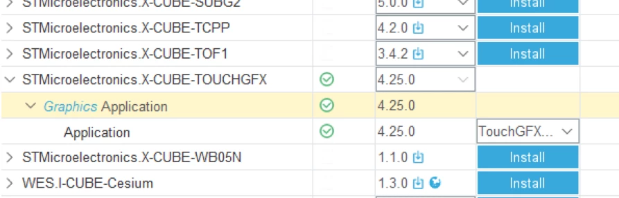

I did never use that selector, but it automatically switched to the correct version:
