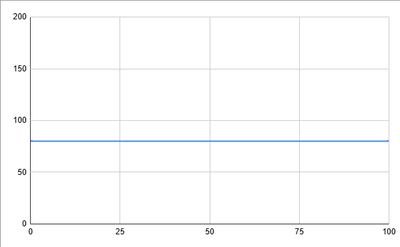

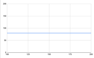

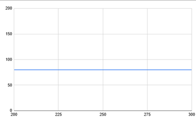

Senior
January 13, 2025
Hi @GaetanGodart ,
I am unable to share the project due to business constraints.
I Currently have worked around the issue by using goToScreen, but just going to the current screen to reload the entire Screen and values.
I have attached some pictures I just made that replicate the issue.
normal scrolling actionnormal scrolling action
Normal Scrolling action
graph.clear()
graph.clear() Normal plotting untill x =100graph.clear() Normal plotting untill x =100
Normal plotting action until x = 100 (whenever scrolling action resumes)
Once scrolling action starts, x-axis jumps to the last greatest x-value(200) as lowest x range value with the whole range full
