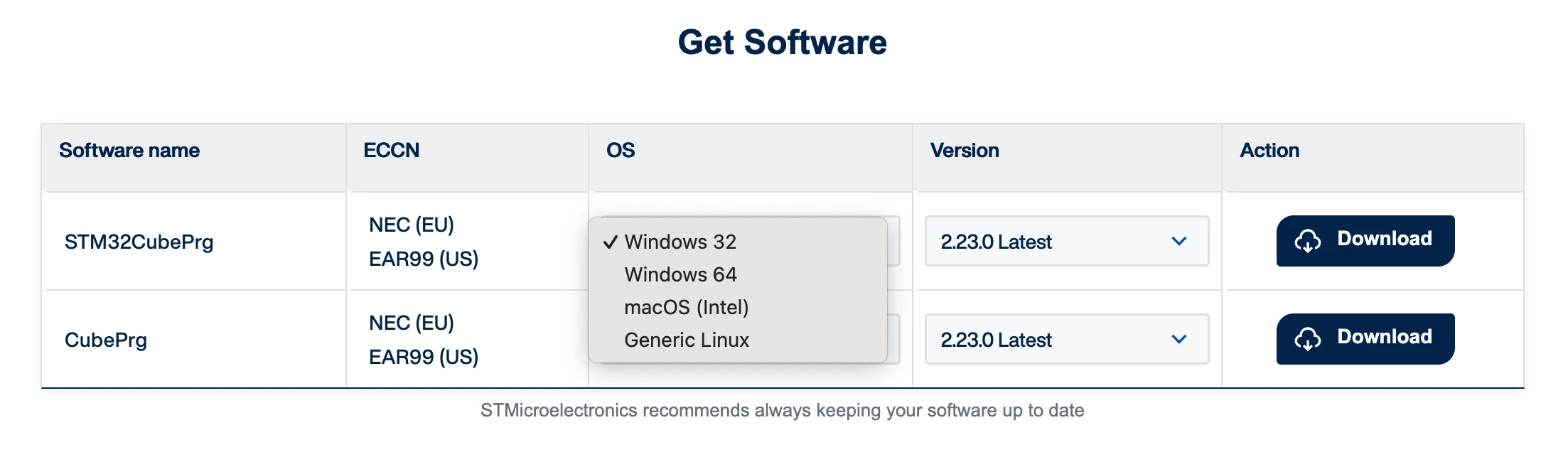

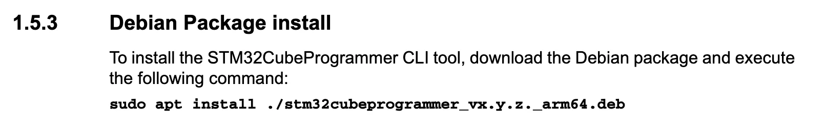

Visitor II
Jun 30, 2026 9:21 AM UTC
It seems that version 2.23.0 has been released, and the newest version of UM2237 describes the installation process. However, the arm64 deb is not available to download.
When can we expect it to be made available?

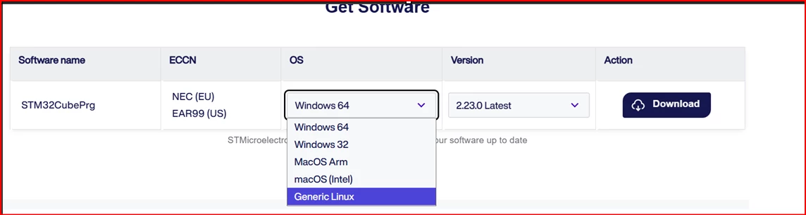

Jun 30, 2026 2:19 PM UTC
In My case it shows , 5 options :
Will this supoorted Older version of Raspberry Pi Model like 3B.
