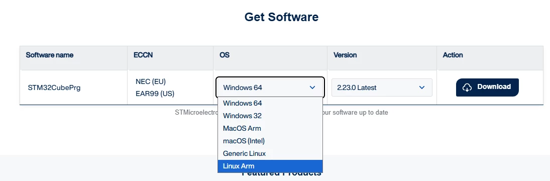

Maxime_BELAVAL
Jun 30, 2026 2:54 PM UTC
 Dear all, ​@aseligmann, ​@bsuthar,
We would like to apologize for the delay in making the Linux Arm 64-bit package available for download.
A technical issue occurred on our side during the upload process, which prevented the package from being published as planned along with the others.
We have been working on resolving the issue since this morning, the package is finally available under the name “Linux Arm” :
​@bsuthar, the “Generic Linux” package is for linux computers. This package includes the GUI & CLI.
The “Linux Arm” package has been built specifically for Arm 64-bit platform, like Raspberry Pi, and is CLI only.
Really sorry for the inconvenience !
Please let us know your thoughts on this first release & support.
Max

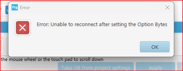

​@Maxime_BELAVAL ,
One Quick Observation , V2.23 takes so much time as compare to V2.22 ( windows 64 ) , for Reconnecting MCU & Throwing Error  after setting RDP2. approx 45 seconds by V2.23. while 5 seconds for V2.22 version.
Maxime_BELAVAL
Jul 2, 2026 8:50 AM UTC
Hello ​@bsuthar, could you please create a dedicated post on the STM32CubeProgrammer forum : https://community.st.com/stm32cubeprogrammer-mcus-30, including the HW involved on your end and the programming interface ? Our support team will take a look at it.
This Dev News aims to centralize all feedback around the new package itself.
Thank you for your contribution,
Max
