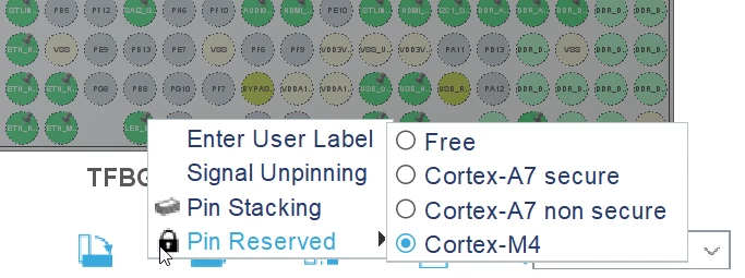

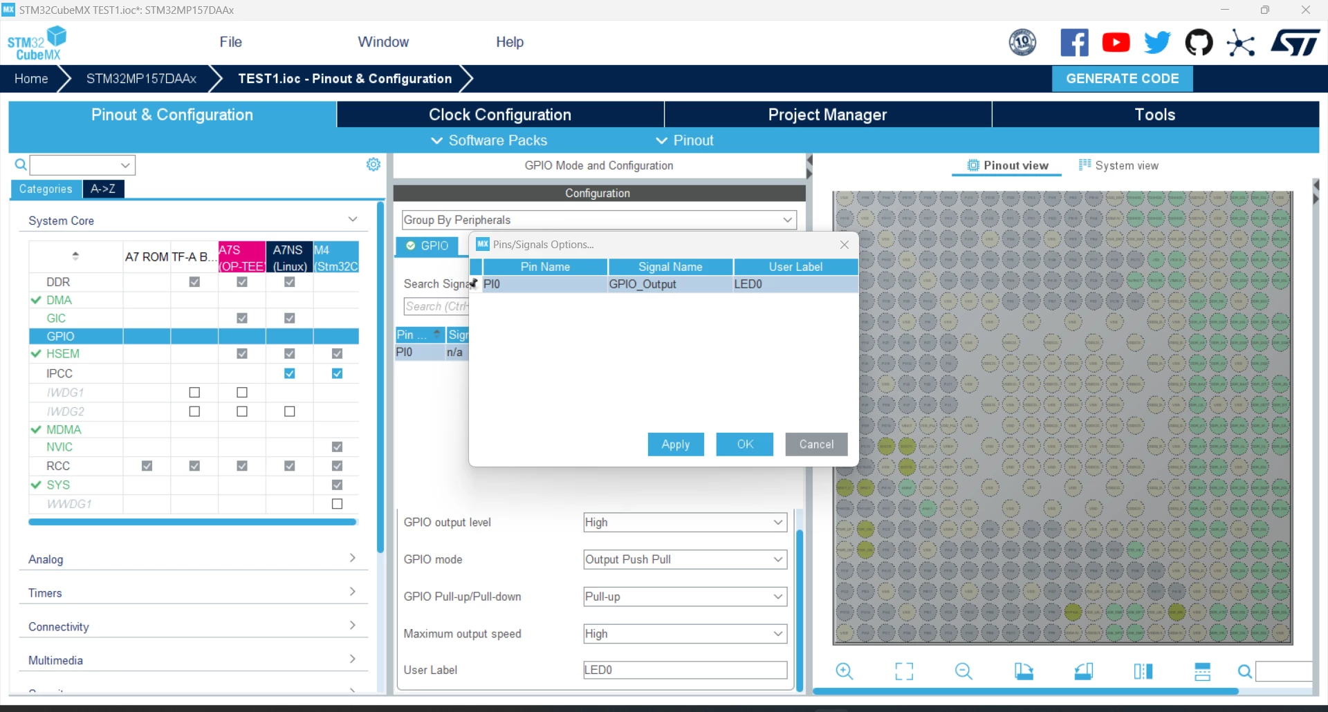

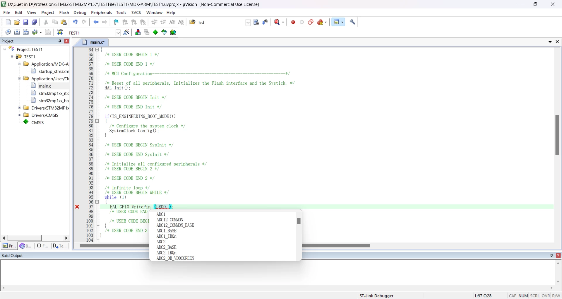

when i use STMCubeMX(version6.8.0) to generate the code about STM32MP157DAA1,i find whether i define the GPIO's user label,it just can't generate in the keil project.
i also find some people say this is a bug,repeatedly click the setting of user label can be solved,but i try it's can‘t figure it out.....
By the way,GPT also not give the correct solution (this is why i am here)​
this is my first question in this commuity,so please forgive the mistake maybe i have done: )

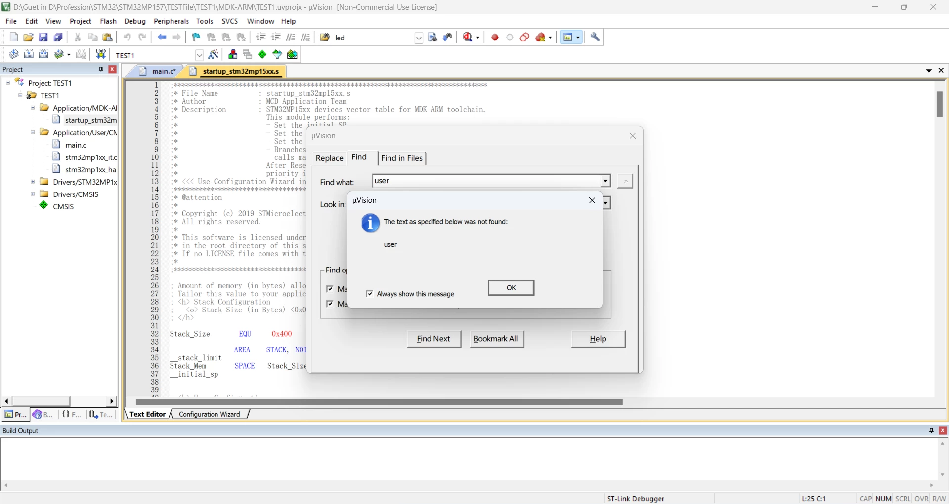

GGree.2
GGree.2Author
Mar 29, 2023 3:56 AM UTC
i create from scratch,but it's not work.
0693W00000aPMUMQA4.png0693W00000aPMTFQA4.png0693W00000aPMI8QAO.pngtips:this search is because GPT tell me if the user label exists, there will be appear some words like ".user intt"(something like this) in this file

Hi @GGree.2​ ,
Did you assign the GPIO "LED0" to cortex-M4 ?
Olivier

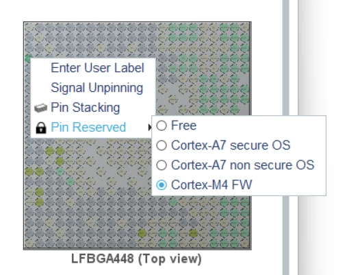

GGree.2
GGree.2Author
Mar 29, 2023 9:28 AM UTC
i did it but it's not work,however there is something werid,my Pin Reserved of Cortex-M4 is follow a word "FW"
like this
