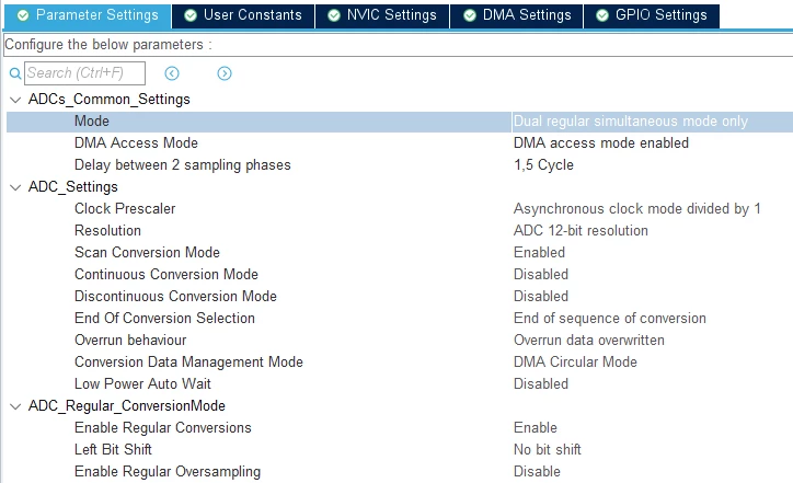

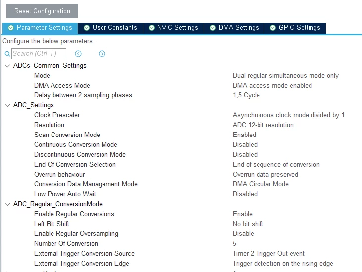

When i used adc in dual regular simultaneous mode, master adc can get correct value, but slave adc can not.
Does anyone have some idea?
These are my ADC 1 and 2 configuration.

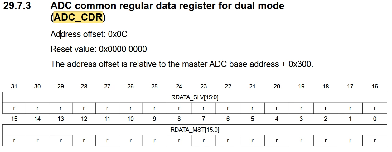

In my understanding adcData_DMA = ADC_CDR so adcData_DMA bits[31:16] = ADC2 Data. Is it right?
uint32_t adcData_DMA[5];
 if (HAL_ADCEx_MultiModeStart_DMA(&hadc1,(uint32_t*)adcData_DMA, 5) != HAL_OK)

ADC1
ADC2
