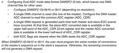

Dear all,
I'm currently using the STM32MP157F-DK2 series, and I'm trying to use the ADC1 and ADC2 in dual regular simultaneous mode triggered by TIM2 out event. Also, I used one DMA stream (DMA2_stream0) to read the ADC values of the Common Data Register (ADC_CDR) as it is indicated in the MP157F reference manual:
This is how I'm starting the ADCs:
if(HAL_ADC_Start(&hadc2) != HAL_OK){
/* Start Error */
Error_Handler();
if (HAL_ADCEx_MultiModeStart_DMA(&hadc1, (uint32_t *)adc_buff, 8) != HAL_OK)

 In my understanding adcData_DMA = ADC_CDR so adcData_DMA bits[31:16] = ADC2 Data and adcData_DMA bits[15:0] = ADC1 data, in that order of ideas this is my callback:
void HAL_ADC_ConvCpltCallback(ADC_HandleTypeDef *hadc)
channels_adc[0] = adc_buff[0] & 0xFFF;
channels_adc[1] = adc_buff[1] & 0xFFF;
channels_adc[2] = adc_buff[0]>>16;
channels_adc[3] = adc_buff[1]>>16;
Where:
uint32_t adc_buff[2] = {0};
uint16_t channels_adc[4] = {0};
I have checked and the values are correct in the Common Data Register (I checked it with the debugger), but the are not in my buffer given by the DMAStream0 (adc_buff).
I don't know if I'm misunderstanding something or if I'm overlooking something. I greatly appreciate your collaboration.
Also I attached here the complete main.c file.
Best regards

Do you mean channels_adc != adc_buff?
jutoroaAuthor
October 4, 2023
Thank you for the repply Ken.
adc_buff is the DMAbuffer, where it's supose to be the ADC1 data (bits[15:0]) and the ADC2 data (bits[31:16]).
The channels_adc[4] it's just the separate value (with masks) of each adc channel. The problem is that in DMAbuffer (adc_buff) it never have the correct values.
It's more clear?
October 6, 2023
Hi jutoroa,
The "DMAbuffer (adc_buff) never have the correct values", it means ADC1(channel 6, channel13), ADC2(channel 2, channel 6) never have the correct values or some channel can get the correct values.
I have encountered a situation where, in Dual ADC regular simultaneous mode, the ADC slave channel has a phase shift of one sample being ahead of ADC master. (I am not the only one seeing this issue.)
https://community.st.com/t5/stm32-mcus-products/stm32h7-adc-dual-mode-simultanious-mode-problem/td-p/294976/page/2
I'm not sure whether you have also encountered the same problem.
jutoroaAuthor
October 17, 2023
Hi Ken, thanks again for the repply. I still have the same issue. The problem is that one channel can't get the correct values into the DMABuffer. I have read the post, and I think it's correlated. ¿Do you know about a possible solution?
