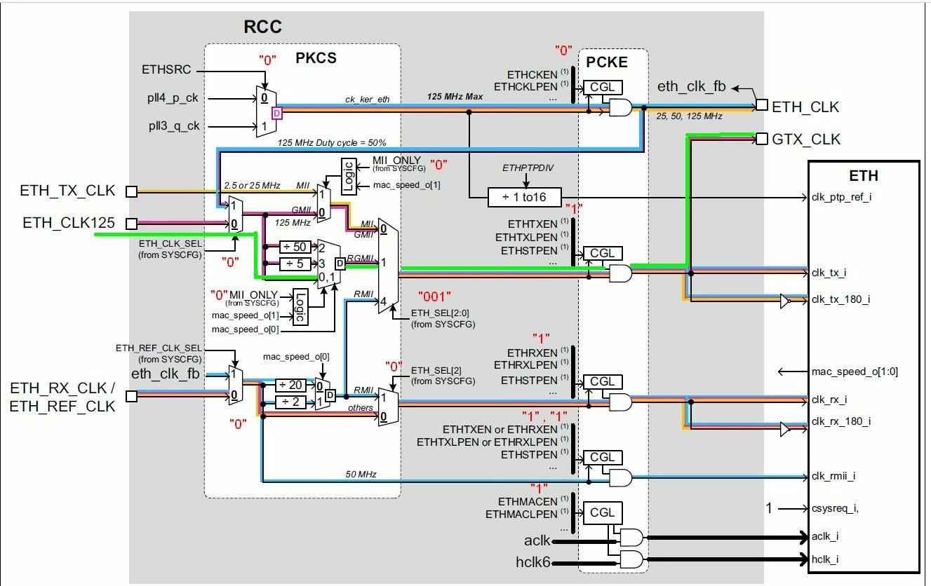

I use a STM32MP157C and connected to MAX24287 PHY by RGMII.
After linux booted there is only 100Mbps connection - I put the PHY into Diagnostic Loopback Mode and the situation is the same.

The PHY has 25MHz external clock, it gives 125MHz RX_CLK clock to the MAC, and the MAC would have give 125MHz TX_CLK (as GTX_CLK) to the PHY.
But with auto-negotiation the output on TX_CLK is only 25Mhz as 100Mbps.
This readable in the MAC registers:
devmem 0x50000A10 w 0x10800
devmem 0x50020004
0x00200000
devmem 0x500008FC
0x00000000
devmem 0x50000218
0x01004701
devmem 0x5800a000
0x0807E203
here ought to be 0x08072203 but the mac_speed_o[1] bit is "0" after negotiation.

in my hardware the STM32MP157C processor connected to the MAX24287 PHY which converts the signals to 1000BaseX form and it connects to a SFP module with fiber! This fiber goes to an media converter which holds the same SPF module and the converted signal connected to my PC by RJ45 TP cable.
To your first question - yes everything connected to each other.
Yes I read the wiki you mentioned several times and I use the
"3.3.4 RGMII with Crystal on PHY, CLK125 from PHY (Reference clock (standard RGMII clock name) is provided by a Phy Crystal)" description.
I have external 25MHz oscillator on the PHY, it gives 125MHz clock to the STM32 processor on pin ENET_CLK125 PG5 and ENET_RXC on pin PA1. The processor need to give 125MHz clock to the PHY on pin ENET_TXC PG4.
I use this version: "en.SOURCES-kernel-stm32mp1-openstlinux-5.10-dunfell-mp1-21-11-17.tar.xz"

my another idea: something wrong happen, when the auto-negotiation occur.
If I know correctly the PHY tell to the MAC what speed could connect and the MAC use the same speed afterward. Somehow they could not agree on the 1000Mbps speed...
