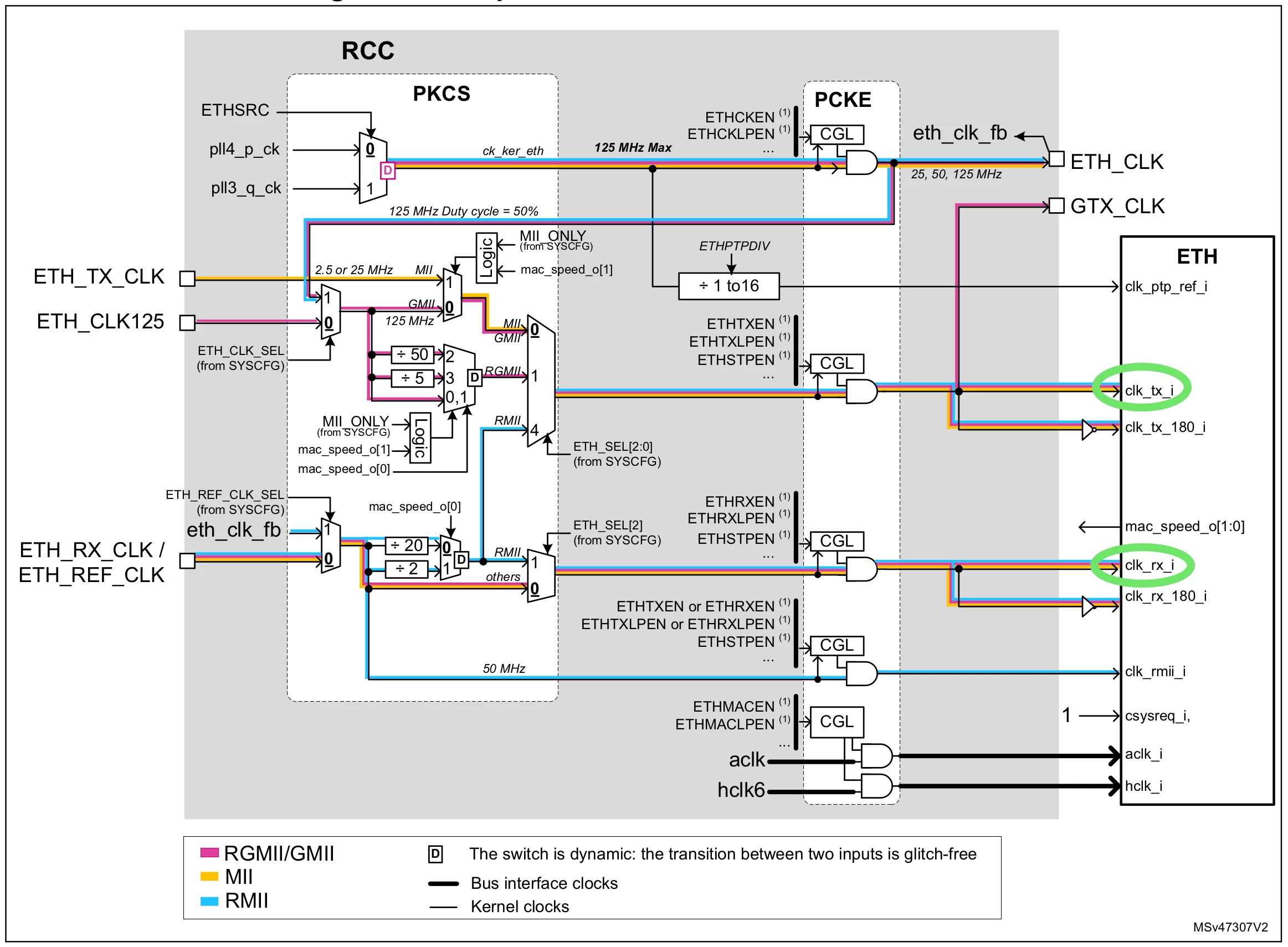

It seems that I have a problem with DMA, but I'm not sure. Would you please take a look at the below screen
0693W00000FDX7aQAH.pngDts looks
0693W00000FDX7zQAH.jpg0693W00000FDX84QAH.jpgI intend to achieve MII with self-generated quartz.
Unfortunately, I'm stuck on this "Failed to reset the DMA".

Hi MWoło.2  (Community Member),
That is the correct value according to your setup: MII with external oscillator/crystal. The applied clocks settings in the DT seems correct.
Have you checked the external PHY h/w connections: VDD supply, PHY boot strapping, reset signal?
What about a dhcp test in U-boot?
Rgds,
Olivier

please check on your board that the PHY is providing a clock on ETH_TX_CLK pin (output from PHY in MII mode) during initialization. Missing this clock is usually the root cause of 'failed to reset the dma' message.
If no clock, please check carefully PHY connections and PHY HW config pins.
Regards.

Hi Olivier, Hi Patrick,
I think I got what is wrong. I experimented with RMII, and when no 50MHz appears on the clock "...fb," I have a DMA problem. It means that this is not a problem with DMA but with the missing clock. Additionally, I tested DIV, MUL in PLL, and when set 100MHz or 25MHz for RMII, it also indicated a DMA problem. Only 50MHz pass for RMII. So after reading the documentation RM0436 Rev 5 section Clock distribution for Ethernet (ETH), everything seems precise. Unfortunately, I can't understand why I have no clock on lines.
0693W00000GXe6TQAT.pngDo You have a receipt for that? Why on RXC and TXC I notice nothing, it should be 25MHz on both, am I right? If Yes, how to achieve this?
