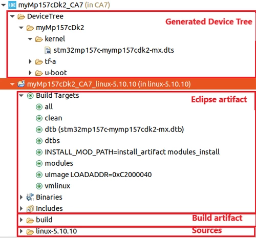

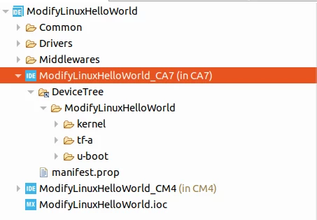

  • I don't have any reference for the run or build configurations.
  • I have not found any information to find the Eclipse or build artifiacts as found in the example I have linked:
What I have:
0693W000008zhV1QAI.pngWhat I am looking to do, as per the guide:

Okay, I didn't realize there was a step needed. I thought the top level of the project already had the Linux configuration built in. So what I did was:
Right click your A7 project -> select "Import an OpenSTLinux project" -> Choose linux-5.10.10 -> then build all.
I am currently waiting for that build to finish which I expect to take almost all day since I am assuming it is doing a bitbake? Once this is done, is there a way to export a .raw file so I can use dd on it to flash an SD card? All of the other howto guides from here on seem to have it use the STM32 CLI tools only.

Ok, so now you can import OSTL projects as explained here: https://wiki.st.com/stm32mpu/wiki/How_to_manage_OpenSTLinux_project_in_STM32CubeIDE
I do not see them in your screenshot...
Take care that downloading and installing SDK is quite long. It should end-up with a SDK Install success pop-up.
Ludovic

VWied.1AuthorBest answer
Apr 20, 2021 18:03 UTC

If your SD-Card contains Starter Package : OpenSTLinux binaries, and if you want to use a resource on Linux Cortex-A7 side, only an update of Linux device tree is needed.
This can be done with Linux project Build target dts (***.dtb) . Then, you can update your board following https://wiki.st.com/stm32mpu/wiki/How_to_manage_OpenSTLinux_project_in_STM32CubeIDE#Linux_project
Take care to update the extlinux.conf file corresponding to your board in order to take into account your new Device Tree.
This can be check in boot message on the Device Tree prompt in u-boot.
Does this answer to your need?
Ludovic
