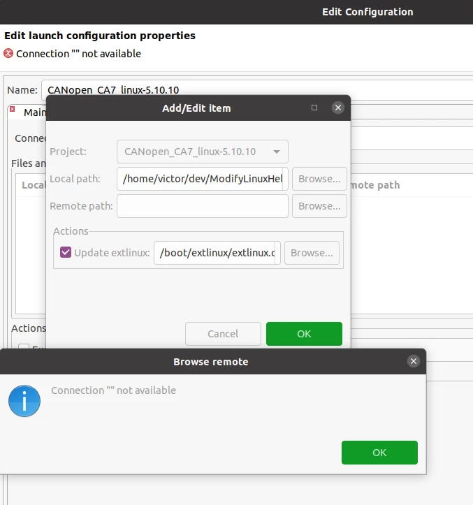

For getting the launch configurations, I am still having the same issue though. I still have 'Connection "" not available' See the image below. When I try to add the configuration like the guide tells me to, I get this:
VWied.1

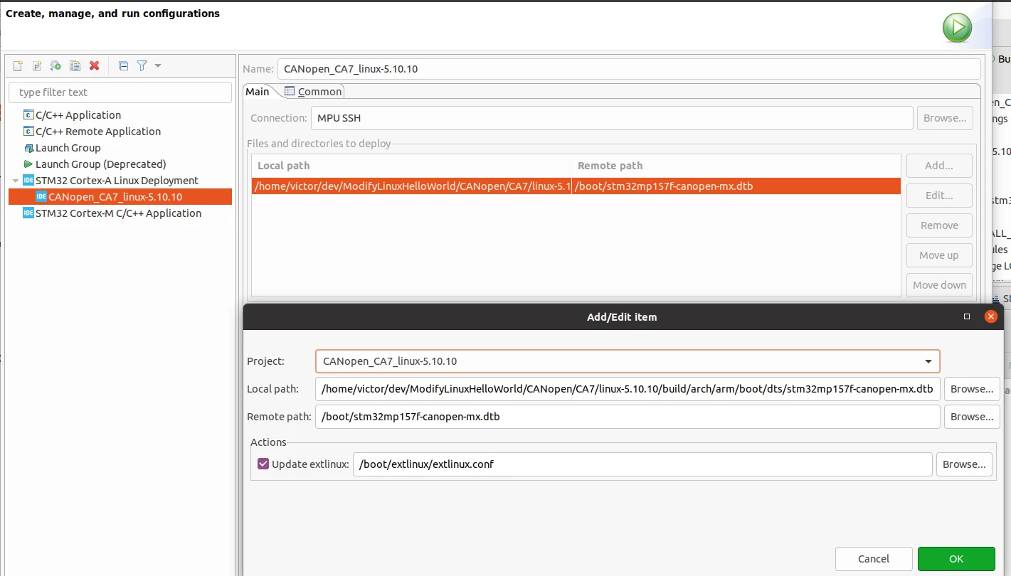

Apr 28, 2021 18:27 UTC
So I found another community.st.com answer that mentioned that this scenario can be because the dependency of openocd is missing. I have apt installed that and I am able to find a connection now. From here, I select the local path and remote path as described in the debugging guide you shared earlier. You can find the setup that I have done for the Run configuration and the error:

Hi VWied.1,
First point, openOCD is part of STM32CubeIDE delivery and by default this embedded one is used.
The problem you are facing is a pure network issue:
. did you check network connection between your Linux workstation and STM32MP15 board?
. is ping working?
. target status green light?
. did you try to select a select a connection?
Best Regards,
Ludovic
VWied.1
VWied.1Author
Apr 29, 2021 17:14 UTC
Hello @LudovicR​
I can ping the device.
The status light is now green.
I can also do "minicom -D /dev/ttyACM0
I can ping the device using the IP address that shows up in the bottom right of STM32CubeIDE now.
I don't know what has changed from yesterday, but I am now able to push a new dtb file to the device which is nice.
I am able to debug linux userspace projects as well.
