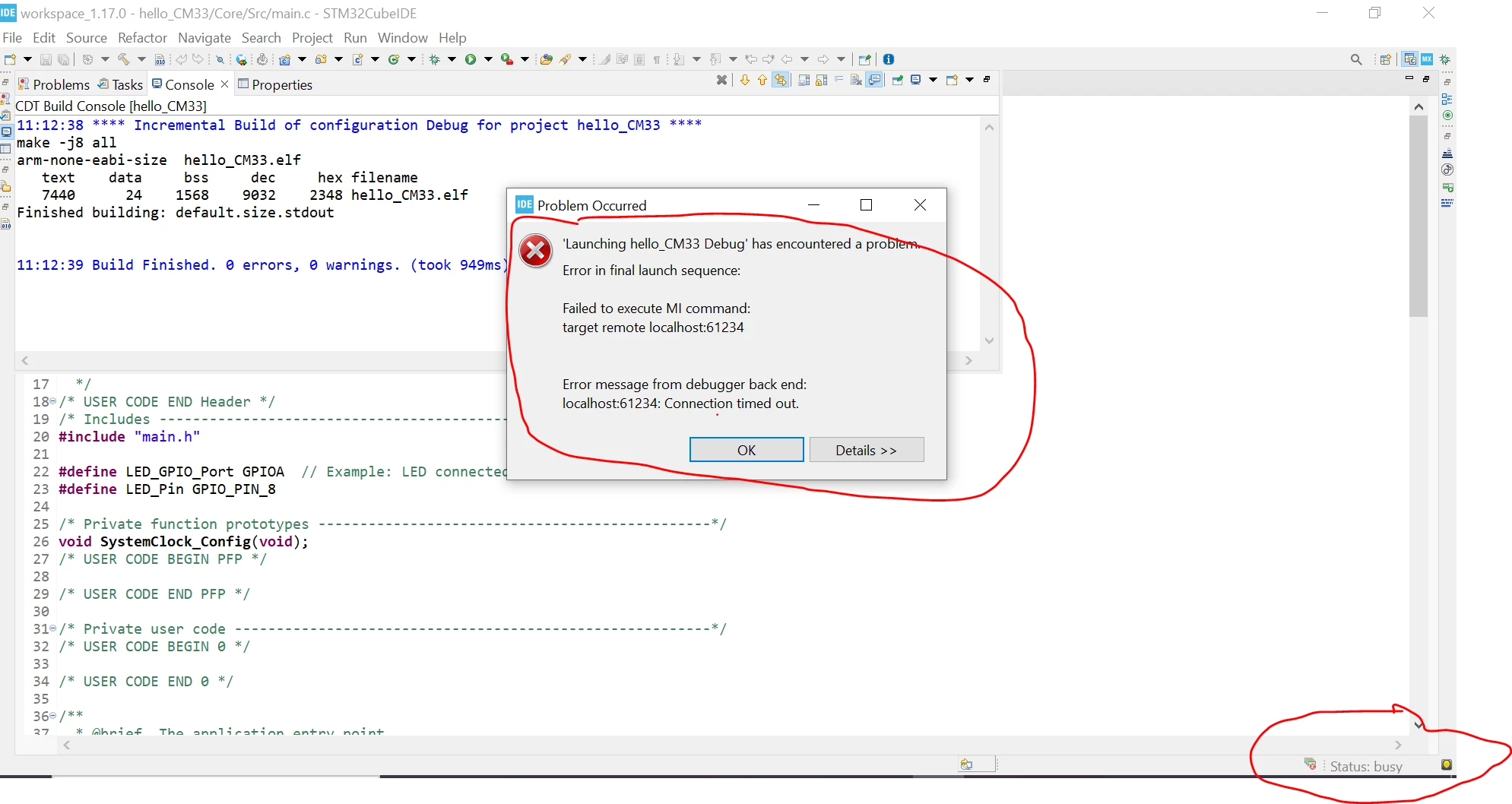

Hello Anyone can Help me to solve this Issue  I am using STM32MP257F-EV There is  a week ego try to troubleshoot this issues by installing all necessary drivers  but still not working , when I want to run the code via IDE it is showing busy and COM ports number, Any assistance please
Give more detail on that - I don't see it in the screenshot provided.

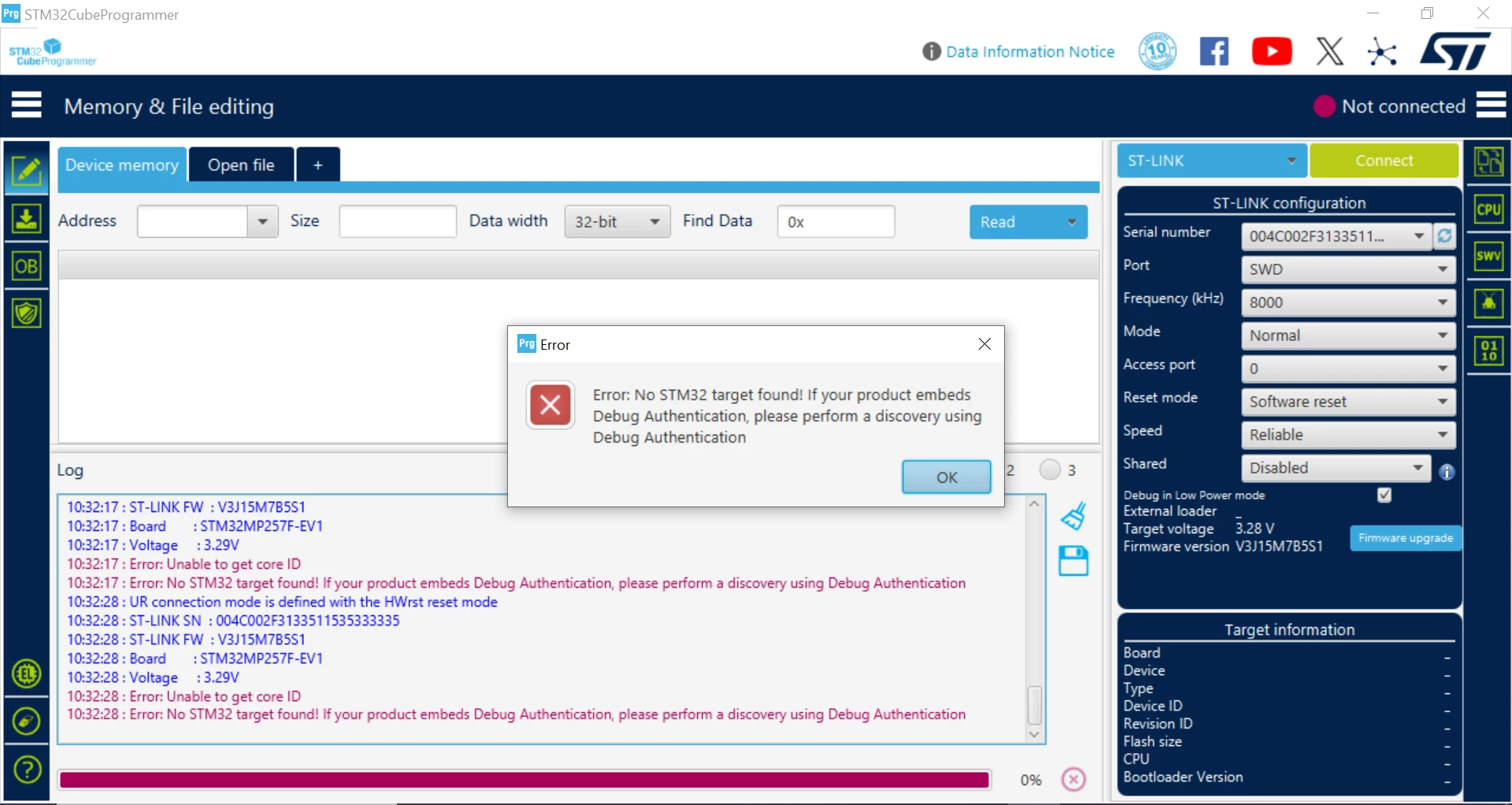

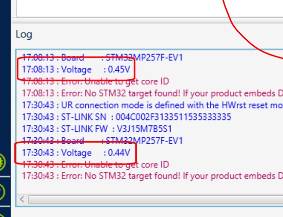

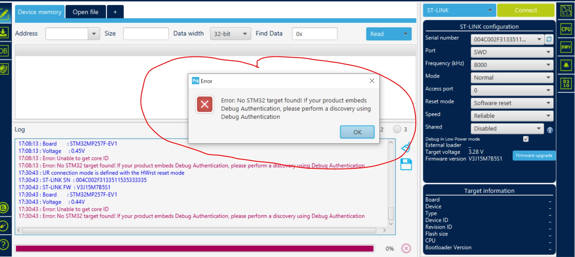

But what the screenshot does show is that your target has no power:
Mar 12, 2025 9:37 AM UTC
@andrew,  the screenshot is showing the voltage of 3.29V you can take a look on this screenshots,

Anyhow, @Olivier GALLIEN has already given the answer:
@Olivier GALLIEN wrote:
This is normal. STM32MPU product doesn't support flashing through ST-LINK
Please mark the solution:
You might use USB boot.
Check-out STM32MP257x-EV1 - stm32mpu
Olivier

Thank you for your feedback, but what I mentioned early is running the code through the board using STM32CubeIDE, about flashing is already done with stm32mp2-openstlinux-6.6-yocto-scarthgap-mpu-v24.11.06 Starter package, is where I have used USB boot mode.
see the screenshot below:
And I was thing that it is because of in STM32Cubeprogrammer does not find the STM32 Target to be connected.
I think its clear now.
