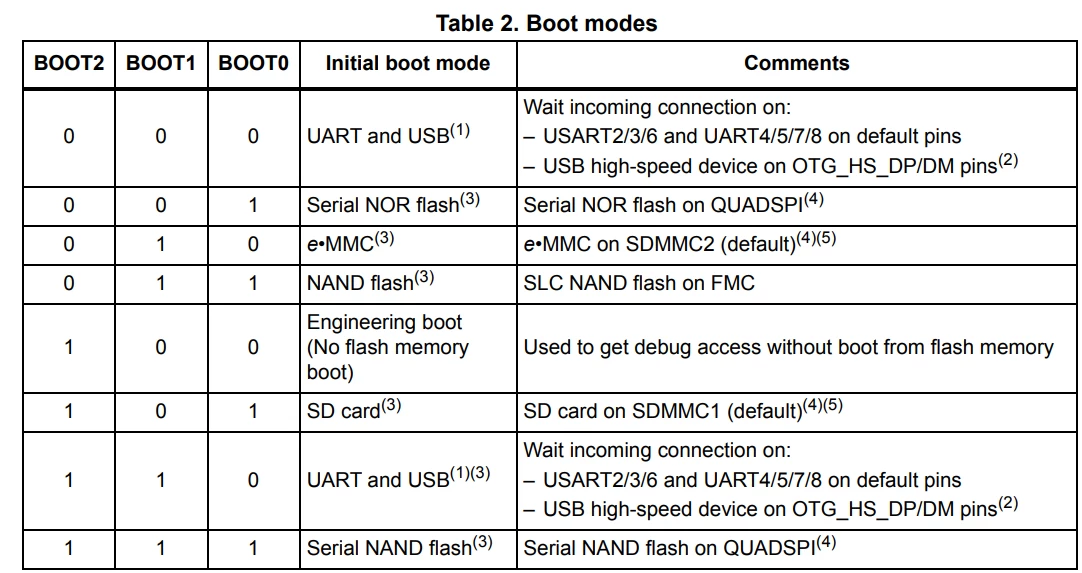

I am designing a circuit with stm32mp157f.
I'm looking for eMMC when choosing memory because 4Gbit slc nand flash is too expensive.
In the datasheet, I read in the data sheet that stm32 supports emmc.
The question is as follows.
  • Is it correct that eMMC can be used even if it is not SLC(pSLC, MLC...) like IS21EF04GP-JCLI-TR?
    (It's my first time using mpu and memory. So it's very difficult for me to choose memory.)

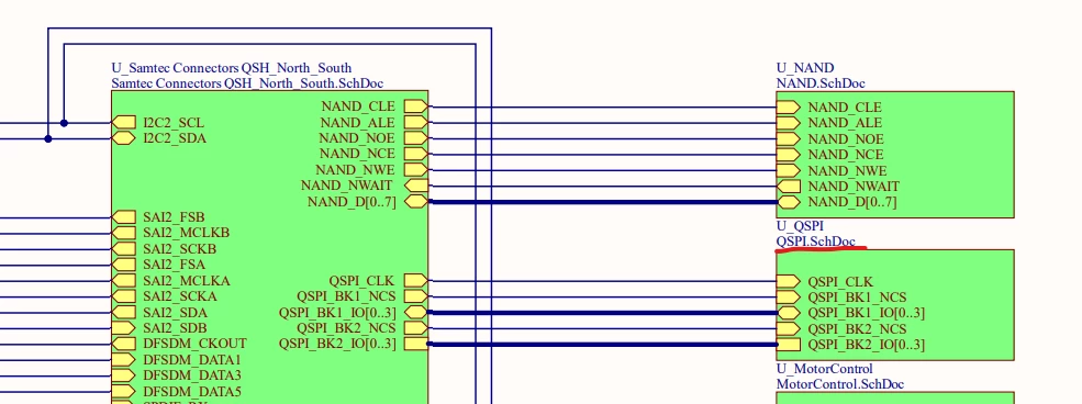

  • Is the QSPI flash of STM32MP157F-ev1 used for RAM?
Regards,
Youngjun.
PatrickF
PatrickFBest answer
Apr 7, 2025 7:07 AM UTC
Hi @Younjun
1st question answered in https://community.st.com/t5/stm32-mpus-products/can-i-use-any-kind-of-emmc-for-stm32mp1/td-p/790740
2nd question answer is No. QUADSPI of STM32MP1 only support Flash.
RAM is DDR connected on DDRCTRL/DDRPHY (external DDR is mandatory to use the platform as internal RAMs are very small)
