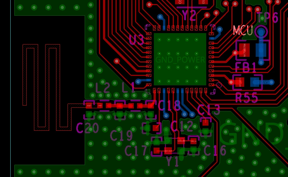

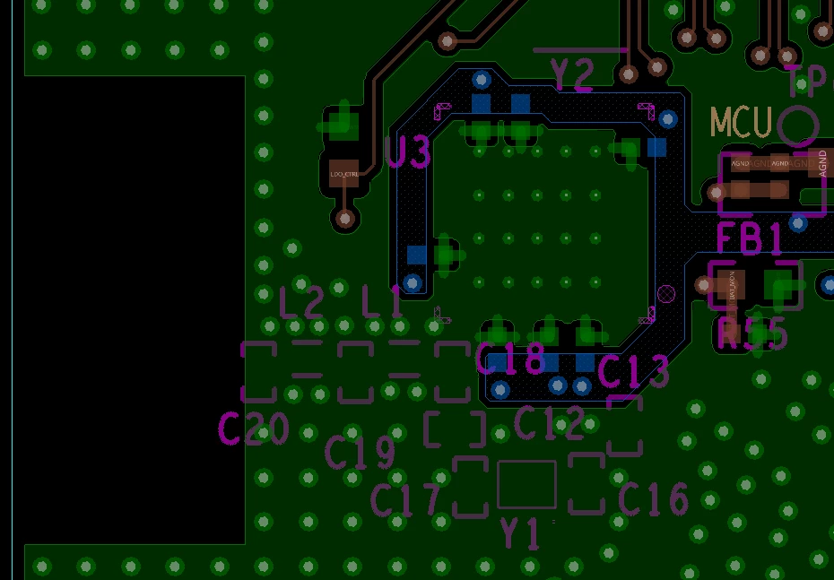

Hello Team,
We have manufactured 500 boards using STM32WBA52CGU6. During testing, we tested 50 boards, out of which 5 boards are not advertising BLE, while the remaining 45 boards are working normally.

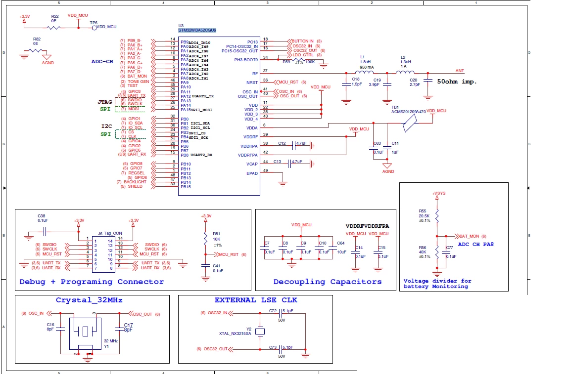

We have attached the schematic and PCB layout screenshots for your reference.
Our PCB is a 2-layer board, and we have not followed a controlled 50 Ω impedance for the RF trace. Could this be contributing to the BLE advertising issue on these 5 boards?
Could you please review the attached schematic and layout and help us debug this issue? We would also appreciate your guidance on the key parameters or measurements we should check
on the failed boards compared with the working boards.

I see one big concern.
C12 must be 470nF and not 4.7uF.
This is mandatory and could explain for sure issue you observed.
Also for for oscillators, please check below wiki page.
HSE and LSE: How to select crystals and center oscillators with STM32WBAx - stm32mcu
You should use a 8pF Xtal for HSE and not set any external caps  (C16/C17).
Finally, as using STM32WBA52 (meaning a LDO version so that current consumption is not optimized), you may also not use LSE (and save the cost of it).
See below wiki page
How to run an RF application on the STM32WBA without LSE crystal - stm32mcu

This is not my area of expertise, but I recommend you follow the AN5948, try checking and correcting the impedance using discrete components. STM32WBA antenna matching

Sep 23, 2026 1:31 PM UTC
Hello Laurent,
Thank you for your great support.
We have updated the C12 value to 470 nF, and most of the devices are now able to advertise using the P2P example code. However, we are still unable to connect to the devices.
Could you please advise if there are any other settings or hardware points that we should check or update to establish a successful connection?
Your guidance would be highly appreciated.

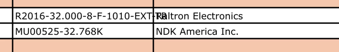

Sep 23, 2026 1:36 PM UTC
Have you also removed C16 and C17?
They should not be set for sure.
Can you please share exact reference of LSE and HSE xtal used?
Regards
Laurent
Sep 23, 2026 1:54 PM UTC
Not removed both caps, please find below part number for both.
Regards,
Hitesh
Laurent LOUAZON
Sep 23, 2026 2:35 PM UTC
HSE.
R2016-32.000-8-F-1010-EXT-TR datasheet says : Cload 8pF, ESR 100Ohms max, C0 : 3.5pF max
It means gmcrit of 2.136mA/V so just limit versus the 2.2mA/V explained in the wiki.
So this should work but C16/C17 must be removed.
LSE
I cannot find detailed  datasheet for MU00525-32.768K.
Seems it is a 6pF Cload version so probabaly  C72 and C73 are close from reality.
Wiki is explaining how to check LSE is properly centered or not.
Please try at least to remove C16 and C17.
Regards
Laurent

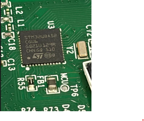

can you sent of picture of STM32WBA52 marking?
Sep 25, 2026 7:38 AM UTC
Attached image of STM32WBA52.
