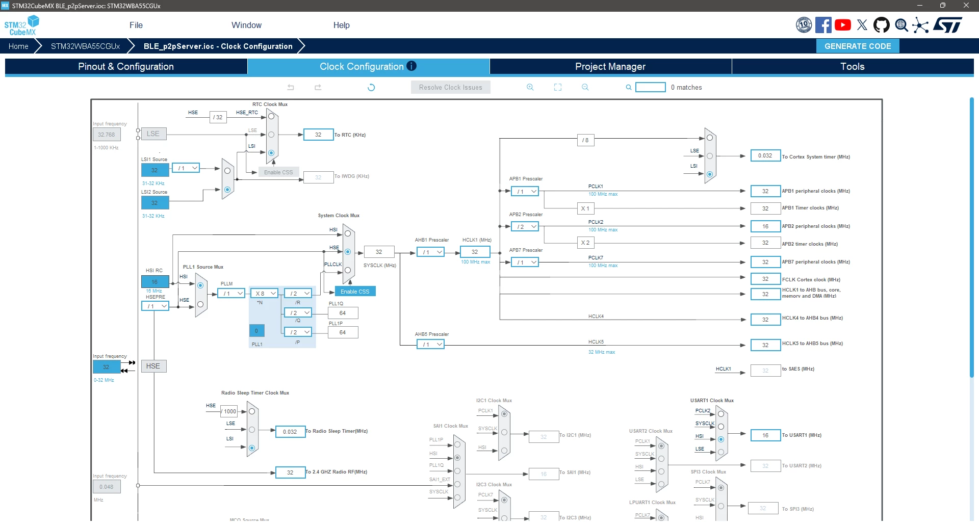

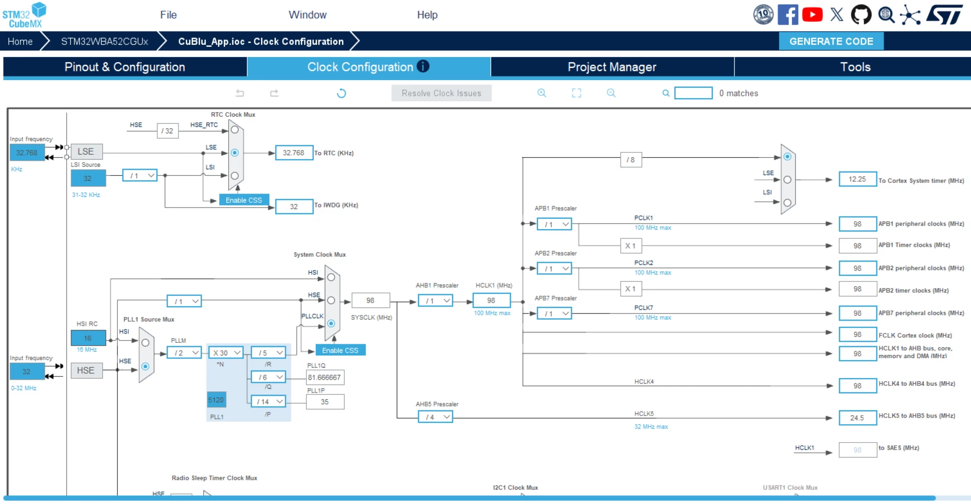

Sep 30, 2026 7:28 AM UTC
We are not able to find the LSI2 option in STM32WBA52. Please find the image below for your reference.
We accidentally tested this using STM32WBA55, where the LSI2 option is available. Please find the attached image for reference.
Could you please confirm whether the LSI2 option is supported in STM32WBA52?
Regards,
Hitesh
Laurent LOUAZON
Sep 30, 2026 9:03 AM UTC
LSI2 is not officially available with STM32WBA52 but practically functional.
This is why you cannot do it through CubeMx but you can do it manually with modification described in wiki.
My idea was here to test LSI2 to see if this solves the concern so that we would confirm issue was related to LSE.
Based on your previous message “However, we also tested the LSE with the configuration shown in the image below, and it is working properly.”, should I understand you are now having a functional PCB and FW using LSE?
