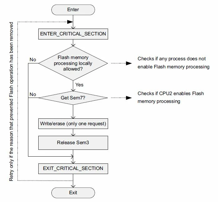

Remi QUINTIN
March 16, 2020
Sem2 gives the ownership of the Flash memory and Sem7 is only used at the time the write access is done to ensure M0+ is not using the Flash memory at the same time.
SEM7 is Used by CPU2 (M0+) to prevent CPU1 (M4) from writing/erasing data in Flash memory
Sem7 is used to protect the CPU2 timing versus write/erase Flash memory operation requested by CPU1. The CPU1 must get Sem7 before writing or erasing. Sem7 must be taken and released for each single write or erase operation, but not for more than 0.5 ms in addition to the write/erase timing. To comply with this requirement, the code has to be executed in the critical section. The algorithm is described in the picture below.

March 16, 2020
Thanks Remi,
The "Release Sem3" is a typo in the diagram? Should it be Sem7?
If so when should I use the Sem2? should it surround this entire flow?
Any chance there's an example code for proper flash erase?
Thanks in advance
Remi QUINTIN
March 16, 2020
Indeed it is a typo . You should read SEM7.
Yes the get and release of SEM2 is surrounding this sequence using HAL_Lock() et HAL_unlock() function calls.
This figure only describes the potential issue of the timing protection for the M0+ to be able to manage the RF IP.
The Sem7 is a way for the CM0+ to allow the CM4 core to effectively write to the flash.

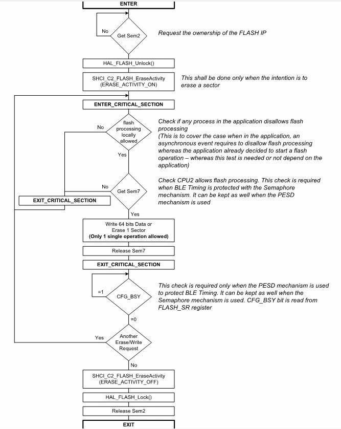

Remi QUINTIN
March 17, 2020
1) Please have a look at the picture showing a more complete sequence for the flash memory access
2) Yes the functions are HAL_FLASH_Unlock() and HAL_FLASH_Lock
APort
APortAuthor
March 18, 2020
Thanks for the diagram, very useful.
I found the issue we've been having - we missed the lock every 64bit write. It somewhat works now.
The lowest connection interval we manged to work with using sem7 is 70ms.
Is this is the expected value for this design?
