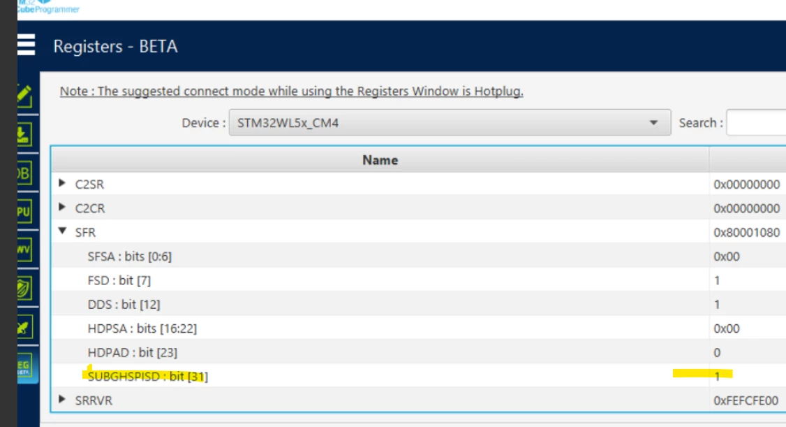

Hello STM Community,
We are developing a battery-powered iot product using the STM32WLE5 (single-core variant) with LoRaWAN communication.
Problem Description
After an under-voltage event, the SUBGHZSPI bit gets permanently stuck at 0. The radio becomes completely unresponsive.
Key observations:
  • The issue **persists across full power cycles** (battery removed for minutes, capacitors fully discharged)
  • A **software system reset** (`NVIC_SystemReset()`) does NOT fix it
  •  **Re-flashing the firmware** does NOT fix it
  • The only known fix is using STM32CubeProgrammer
    • To Reset the bit ( Done in the picture below ). The error is SUBGHSPISD stuck to 0.
    • Once we set the bit to 1 we can resume normal operation.

None of these approaches recover the radio from firmware. Only STM32CubeProgrammer's Option Byte "Apply" action resolves it.

Jul 6, 2026 3:25 PM UTC
Hello nikolas-zeitler,
please have a look at:
STM32WL55 and STM32WLE5 radio timeout issues: A technical FAQ on SubGHzSPI security | Community
BR,
Filippo
1 reply
