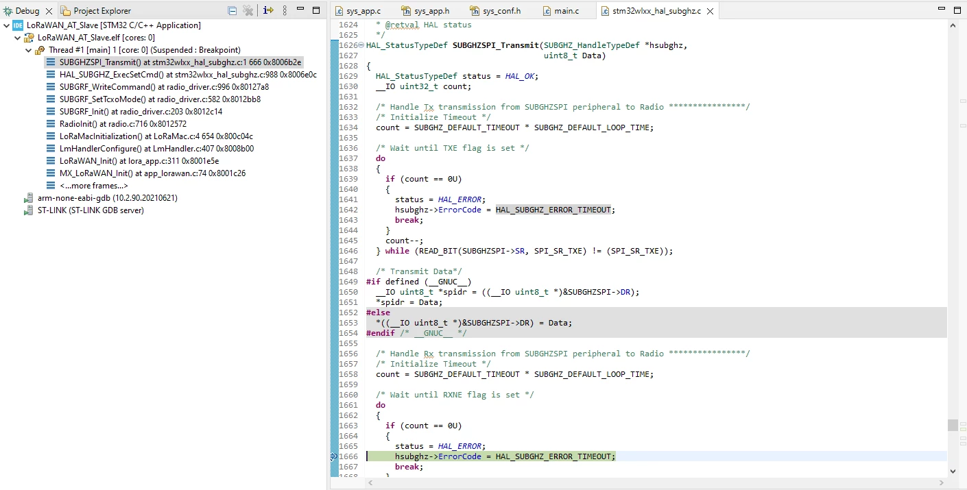

Figure 1 - Timeout in the SubGHzSPI transmit function.

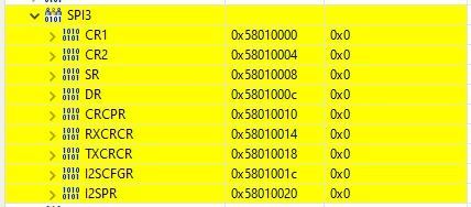

When the driver waits for TXE (Transmit Empty) to confirm that the SPI byte was sent, the registers may appear as all '0x0' values if the security feature is enabled. This causes the driver to timeout, as shown in Figure 1 above. Note that the '0x0' values can also appear if the peripheral is not enabled in RCC. This however usually leads to a Hardfault when attempting to access.
Figure 2 - SubGHzSPI registers when security is enabled.

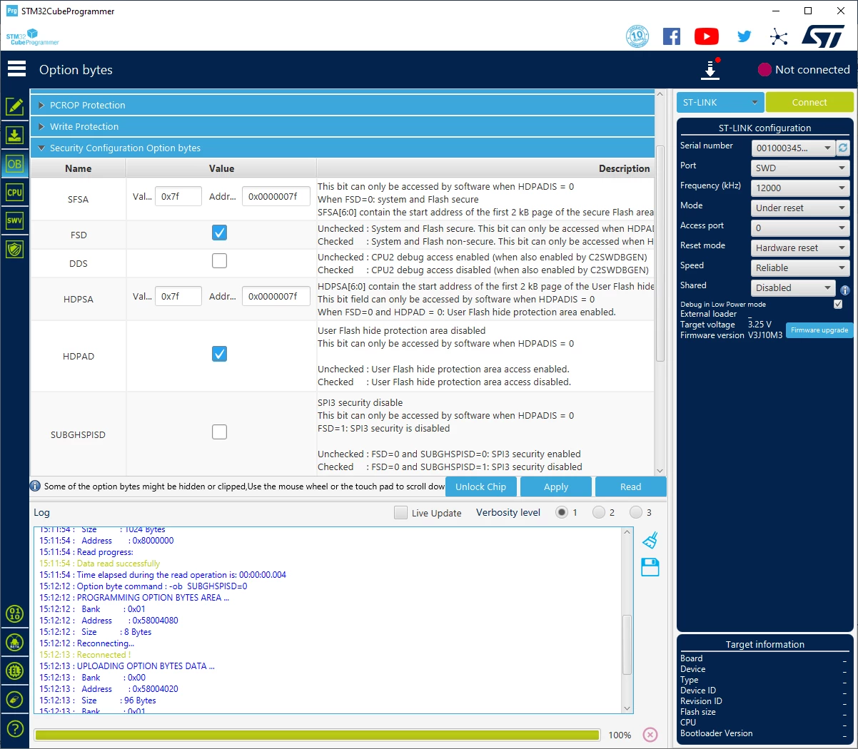

There may be other symptoms that the SubGHzSPI is secured, but the two issues mentioned above are the most common. To verify that the security feature is enabled, CubeProgrammer can be used. With the STM32WL55, this can be seen directly in the "Option bytes" tab.
Figure 3 - STM32CubeProgrammer Option bytes view.

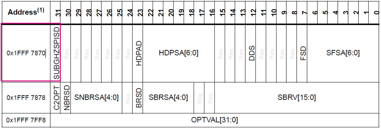

On the STM32WLE5, the option byte is hidden, so it can be viewed only directly from the memory. The reference manual RM0453 specifies the SUBGHZSPISD bit @0x1FFF7870
Figure 4 - RM0453 SUBGHZSPISD Option bit.

1. Problem solution
The solution to this issue is simple - disable the sub-GHz radio SPI security by enabling the SUBGHZSPISD  bit to allow access to the radio. With the STM32WL55, this can be done directly in CubeProgrammer through the Option bytes menu.
However, with the STM32WLE5, the bit is not visible in the Option bytes menu. It is necessary to write into both words at the same time due to the memory check with the negated value. The easiest way to enable the bit on both STM32WL55 and STM32WLE5 is to let the microcontroller do the programming.

When i suspend in debug, i am at line 1645, on the first loop. Mean most of the time is spent there.
With the prog the bit where set as on  sceen shot, but the bug still there

You wrote disable the SUBGHZSPISD, but disabled is CHECKED and it function.
For me the solution was to CHECK the  SUBGHZSPISD.
Regards
JP

thank you for your comments. I improved a bit the explanation in the 1. Problem solution part, hopefully it is more understandable now. (Security is being disabled, but the 'security disable bit' is being enabled).
