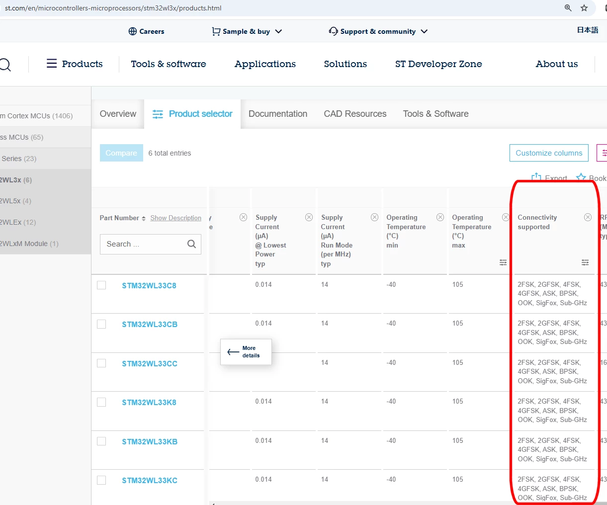

Iam trying look for low budget chip for my application,
Can you guide if stm32wl33 will work for lorawan communication to send temp. data
Andrew Neil
Andrew NeilBest answer
Nov 2, 2024 2:24 PM UTC
Look at the 'Connectivity' column in the Product Selector:
https://www.st.com/en/microcontrollers-microprocessors/stm32wl3x/products.html

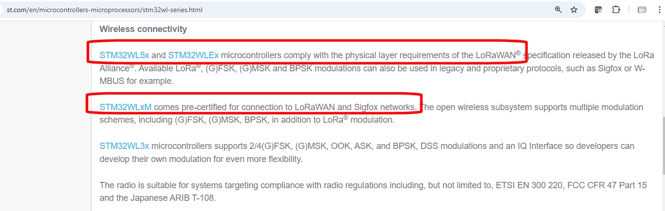

As the name suggests, you need LoRa to do LoRaWAN
See also:
https://www.st.com/en/microcontrollers-microprocessors/stm32wl-series.html

Nov 2, 2024 2:32 PM UTC
Thank you, i noticed it lator.
i am going ahead with WLE series.
