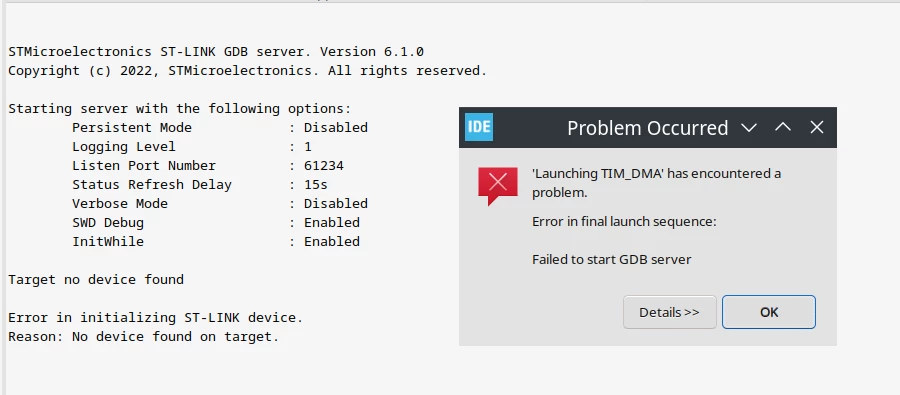

STM32WB55RG Error in initializing ST-LINK device. Reason: No device found on target
I have two P-Nucleo-WB boards and both of them end up in this state.
CubeIDE trying to load binary:

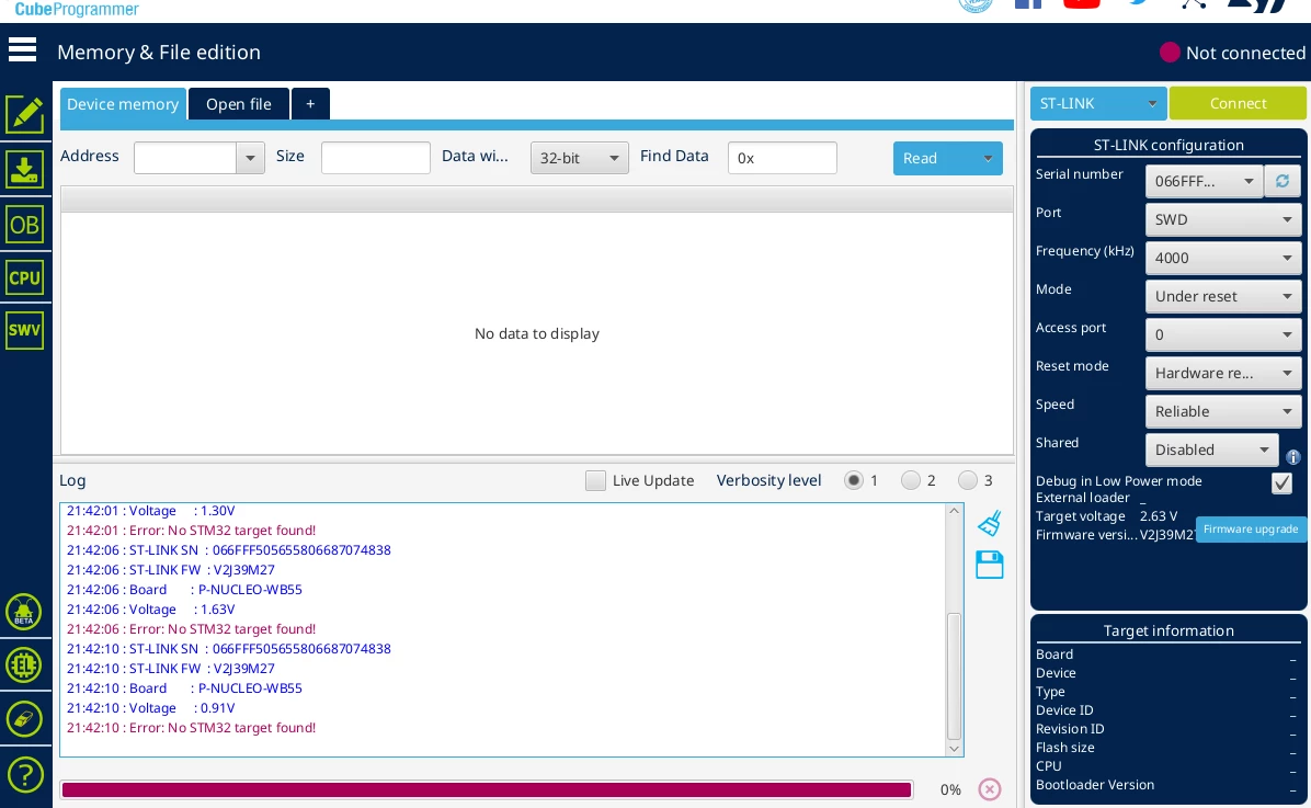

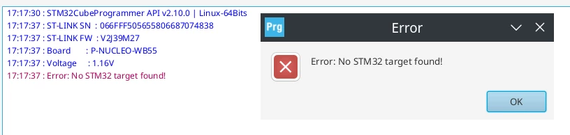

0693W00000NsyFLQAZ.pngCubeProgrammer:
Found several topic that looks the same however nothing helped. Has anyone solved this problem?

I have tried to connect it "Under reset mode" with pressed reset button. Result is the same:

Seems power on your board is unstable. Check it ... Under reset is mode not presed but

Power comes from USB port and it's the same on other ports. Connecting under reset results in this same error. Is there any other method I could try to bring back my stm?

Your power supply seems to be very low, maybe you can try to change your usb cable.

I have checked voltage on my both boards and it seems like both of them got this same issue with voltage:
First board:
5V pin measured 2.5 V and 3V3 pin measured 2.3 V
Second board:
5V pin measured 5 V and 3V3 pin measured ~0 V
Strange is that I have taken precautions after first board failed and only think I did with board was plug/unplug st-link usb cable.
