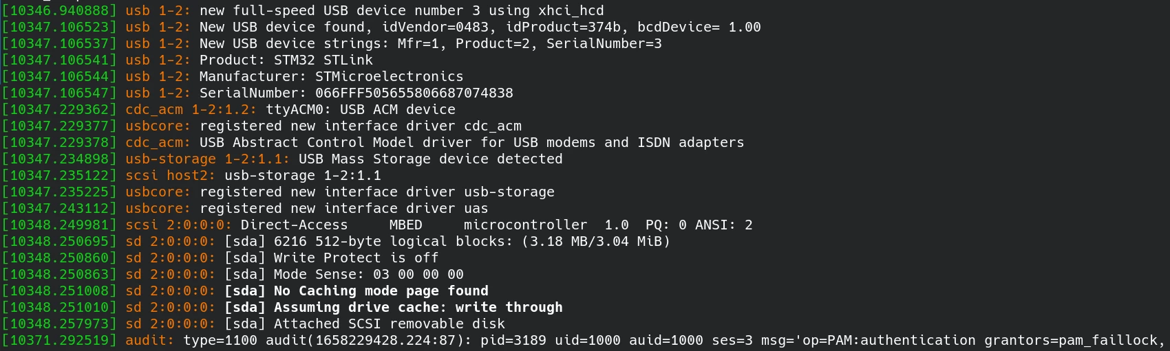

This is how my Linux recognize device:

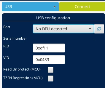

0693W00000QLW33QAH.pngJumpers are set up as you described. I can't connect by DFU:

In order to connect the board using USB DFU mode, you must have the following configuration:
  • BOOT0 pin HIGH: connect CN7 pin 5 to CN7 pin 7
  • JP1 ([5-6] on USB MCU).
  • JP2 is ON
  • JP3 is ON
  • Use USB_USER connector
The following configuration is used to connect the board using ST LINK:
  • JP1 ([7-8] on USB STL).
  • JP2 is ON
  • JP3 is ON
  • Use ST-LINK connector

Hi Remy,
I was able to connect with USB DFU mode however I don't know how to recover option bytes. Could you please tell me how to do that?
