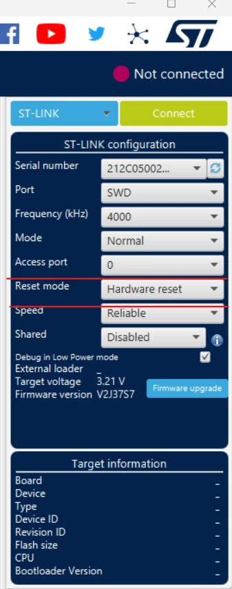

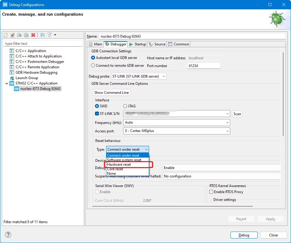

Jan 31, 2024 1:12 PM UTC
Hey Andrew Neil,
@Andrew Neil wrote:
The ST-Link should be able to assert the NRST line.
Did you have the ST-Link configured to do a hardware reset?
Yes, I have configured the hardware reset from the debug configuration, I have also tried hardware reset and other options from STM32CubeProgrammer options, but it didn't work.
So I had to do it manually.
