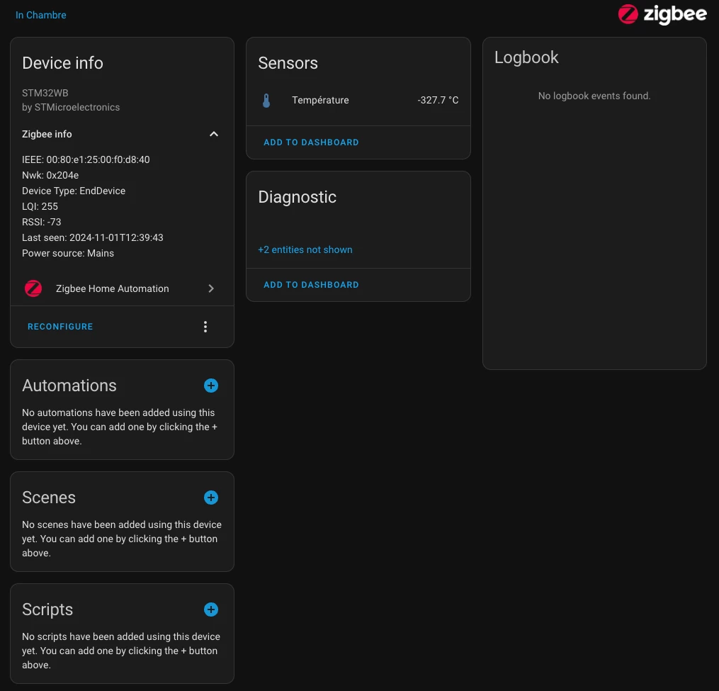

I'm a beginner working on a project using an STM32WB55 with a temperature sensor, and I'm trying to set it up in Zigbee mode with Home Assistant and ZHA as the coordinator. My goal is to update temperature data on Home Assistant, but I haven’t been successful so far (I’ve only managed to join the zigbee network).

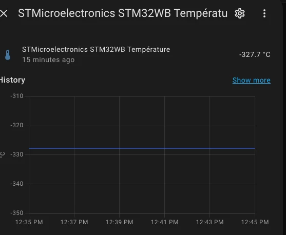

I’ve tried setting up the network and using ZbZclAttrIntegerWrite to update the temperature attribute, but nothing seems to been updated in Home Assistant and the temperature is updated only when my STM32WB join again ZHA (and after that the value remains stuck at -327.7°C).

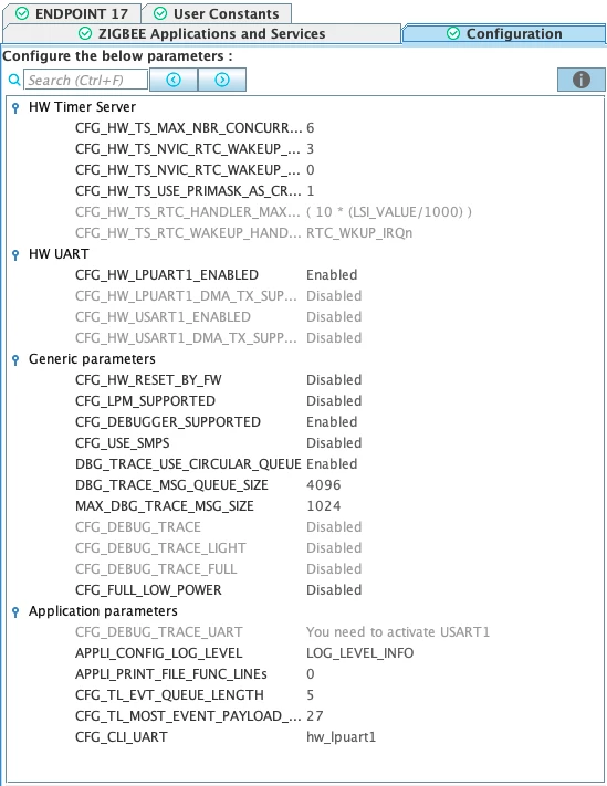

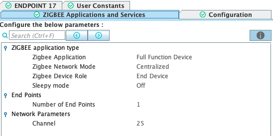

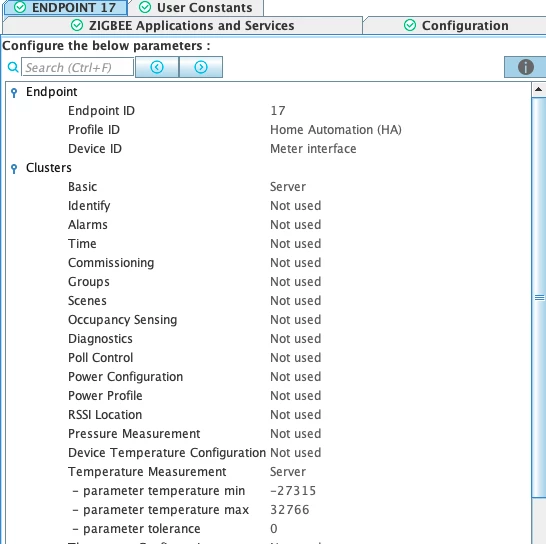

Heres  screenshots of the CubeMX configuration:

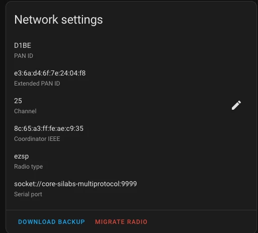

And here's a screenshot of my network settings in ZHA (I don't know if this helps):
