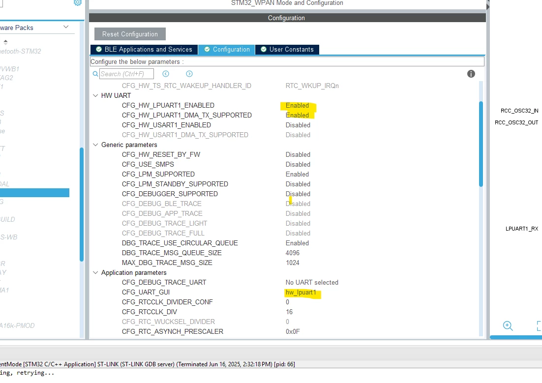

I am currently using the NUCLEO-WB15CC to test STM32CubeMonitor-RF.
I imported the BLE_TransparentMode example to be able to use Monitor RF. Everything works perfectly when using the default USART1 interface.
I also tested the communication using an FTDI cable instead of the NUCLEO’s embedded ST-Link virtual COM port (by removing the RX and TX jumpers), and the FTDI connection works fine with USART1.
For my project, I would like to use LPUART1 instead of USART1 to communicate with Monitor RF. CubeIDE seems to allow switching between UART instances easily. I configured LPUART1 in the same way as USART1, using DMA and the same settings. The configuration compiles and programs correctly, and I have successfully flashed the firmware.
I am using the same FTDI cable, connected to the connect LPUART1 pins (RX: PA3, TX: PB5), but I am unable to establish any connection with CubeMonitor-RF.
(Of course, I double-checked the RX/TX wiring and tried swapping them just in case.)
If I use (RX: PA3, TX: PA2) It is working
If I use (RX: PA12, TX: PA2) It is working
My question is:
  • Is PB5 not allowed for LPUART1? Or is there any specific configuration required?
Thank you for your help.

In the example provided by ST, within MX_APPE_Init(void) → APPE_Led_Init(), pin PB5 was configured as a debug LED.
By commenting out the LED_Init() function, everything now works correctly.
I did not see in .ioc the CFG_LED_SUPPORTED parameter that I could put to 0 instead of commenting the function.
Thanks again for your support!

Hello @Serial-Kellogs and welcome to the ST Community.
Nothing special for the PB5. It should be able to work just fine. Could you please check if it is working well on your board for a simple Transmit (without BLE Context)?

Hello SSTwo-32,
Thank you for your response.
I finally found the root of the issue.
Best regards,
Victor
