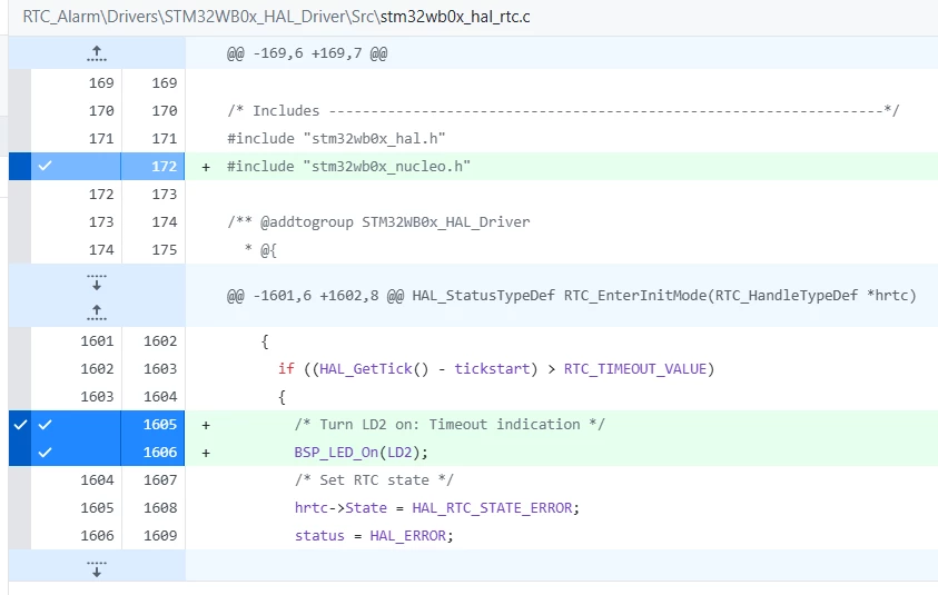

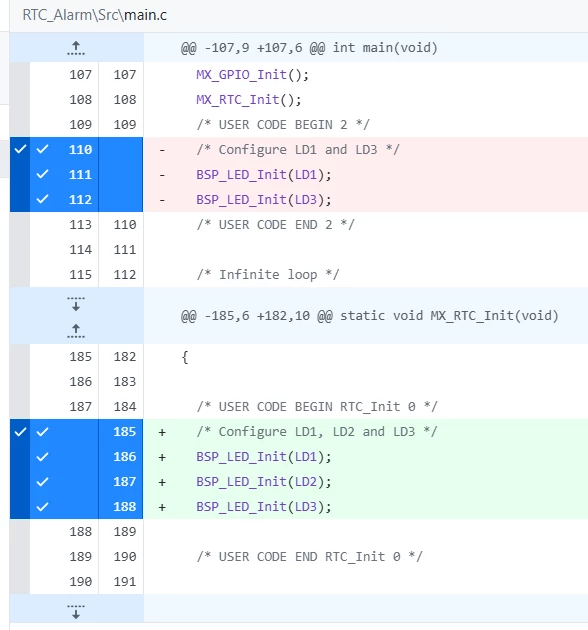

5) Optional: to confirm the specific failure point, make a few small changes to the code so you can observer LED1, LED2, and LED3 on the CN3 and CN4 headers.
- Call BSP_LED_Init() at the beginning of MX_RTC_Init() to ensure the GPIO signals are initialized before the failure occurs:
- Update stm32wb0x_hal_rtc.c so that LED2 is turned on when the RTC initialization timeout occurs:
- Now build and flash the updated code onto the board, then repeat step 3) above.  Now you will see:
a) LED1 (CN4 pin 6) stays 3.3V and does not drop to 0V after 30 seconds
b) LED2 (CN3 pin 23) briefly goes to 3.3V when power is applied, and then drops to 0V when the timeout occurs
c) LED3 (CN4 pin 38) toggles between 3.3V and 0V, as programmed in the example code Error_Handler()
I believe these results prove the existence of a problem with the STM32Cube FW_WB0 V1.4.0 firmware package or with the STM32WB05 silicon.  Could you please confirm that you can reproduce my results and provide some suggestions to move forward?  For now, I have tried commenting out the while loop inside RTC_EnterInitMode() so I can get past the initialization error, but I haven't thoroughly tested RTC functionality to determine whether everything is still working after skipping the initialization confirmation.
