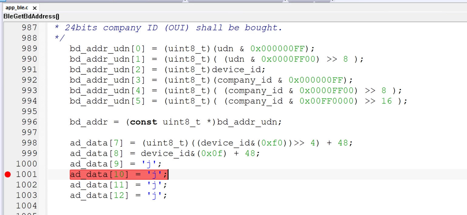

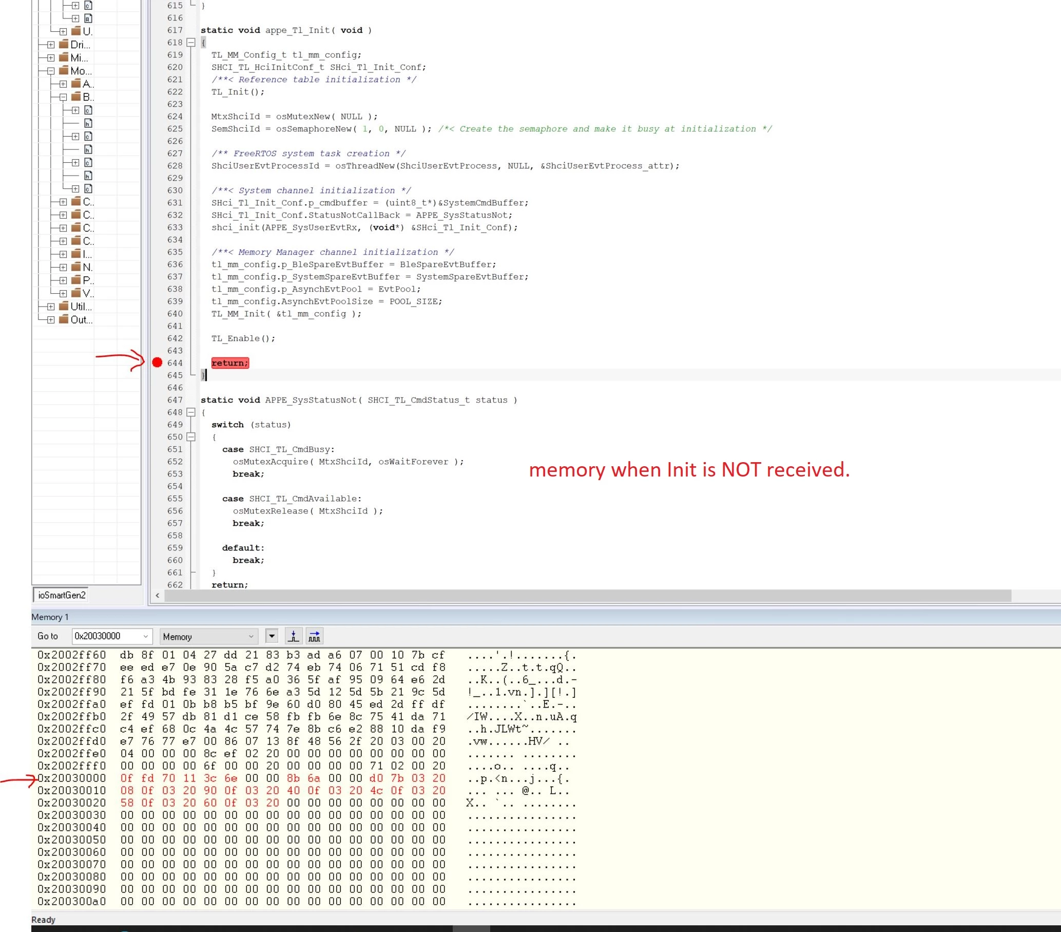

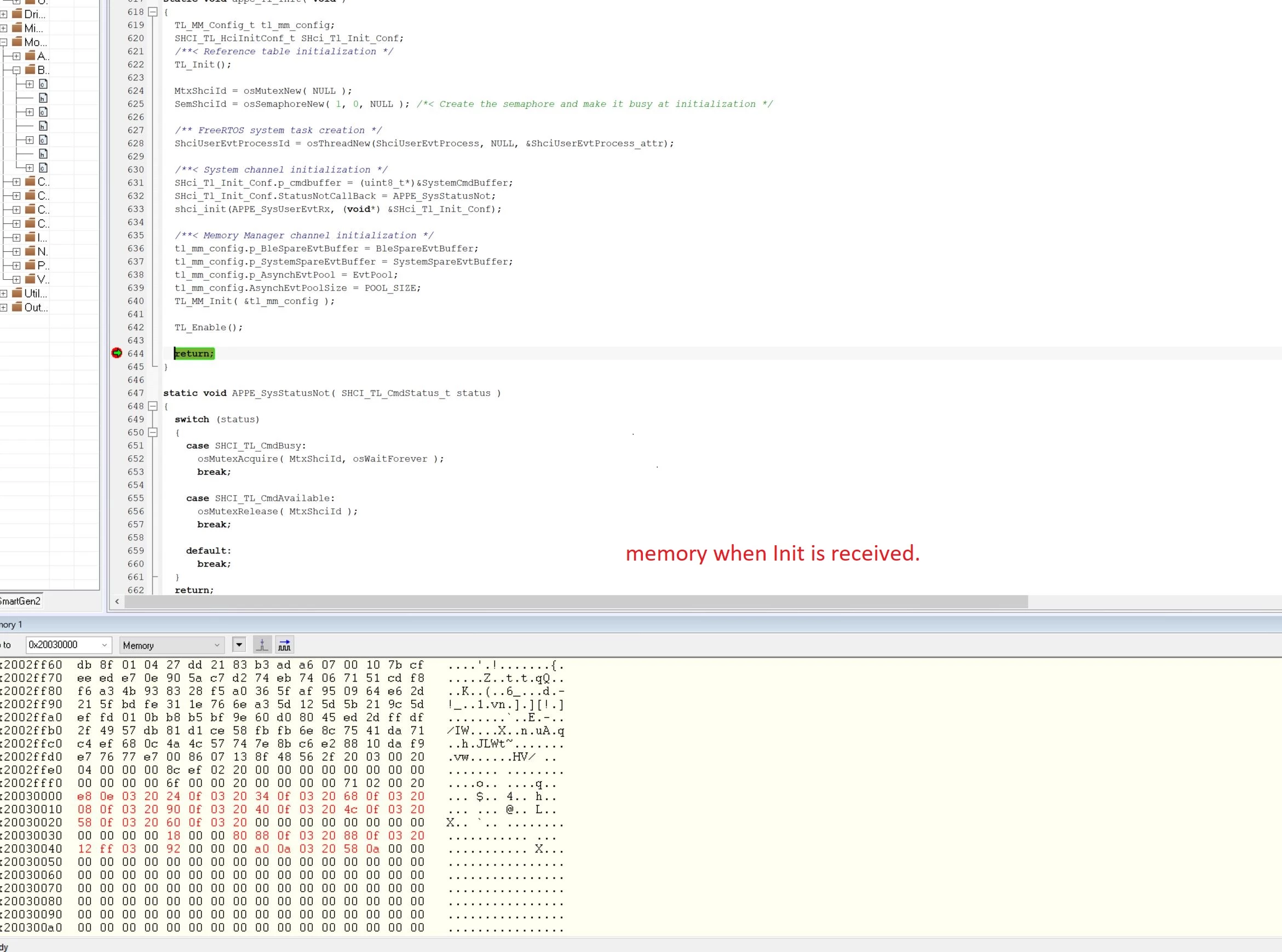

In our application, we have BLE stack fully functional, but every now and then, when we make a small change, like adding a debug line, APPE_SysUserEvtRx callback function doesn't receive a SHCI_SUB_EVT_CODE_READY event.
If we move the change couple of lines down, some times this works, some time it doesn't. Its really very frustrating, as I have not been able to figure out what is causing this issue?
