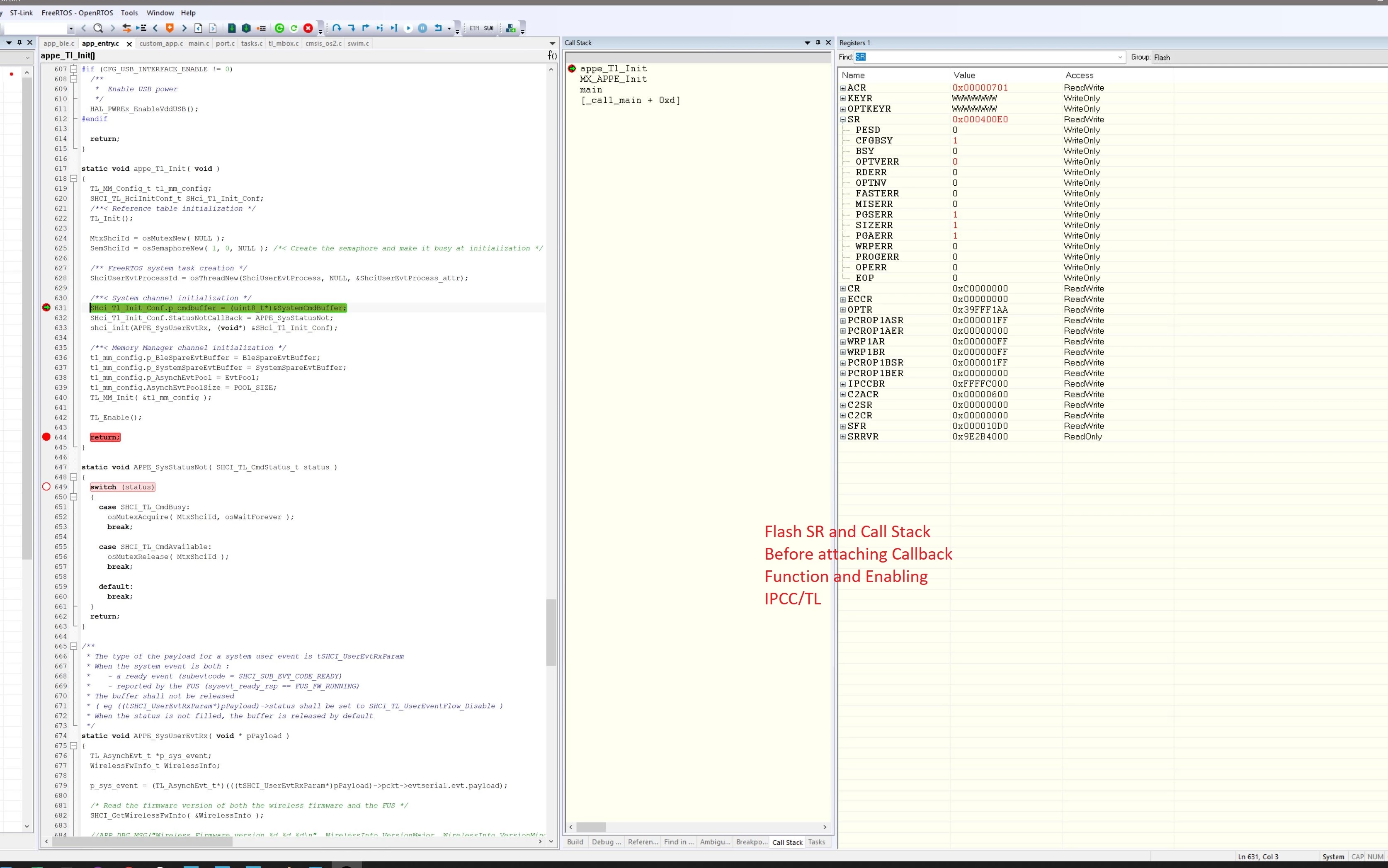

STM32WB BLE SHCI_SUB_EVT_CODE_READY Event is NOT received
I am trying to figure out a root cause for a weird unexplainable error on STM32WB with BLE Stack.
In our application, we have BLE stack fully functional, but every now and then, when we make a small change, like adding a debug line, APPE_SysUserEvtRx callback function doesn't receive a SHCI_SUB_EVT_CODE_READY event.
If we move the change couple of lines down, some times this works, some time it doesn't. Its really very frustrating, as I have not been able to figure out what is causing this issue?
Any help/pointer is much appreciated.
Thanks

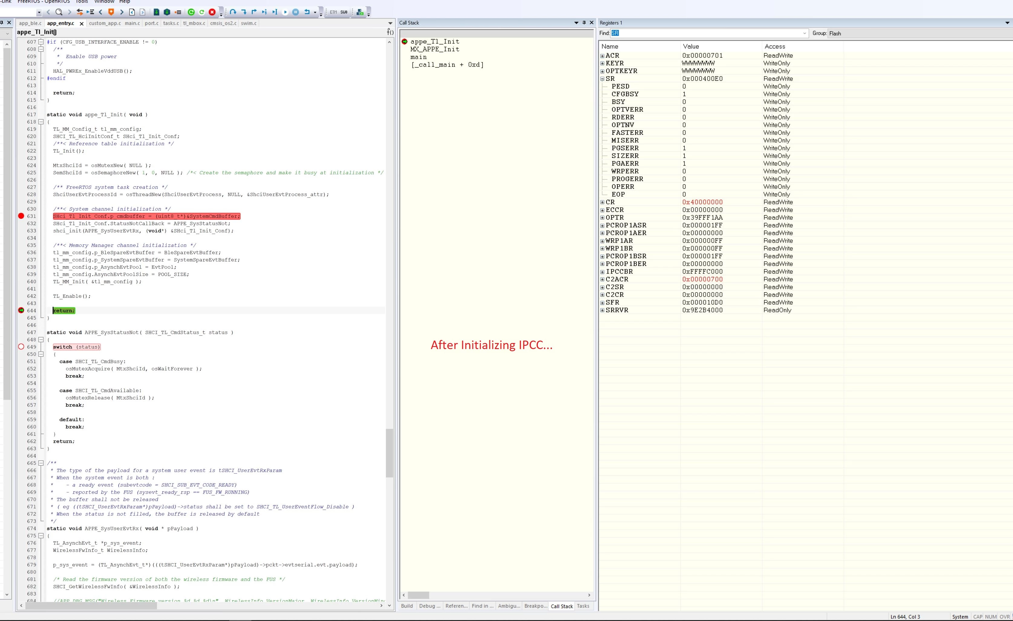

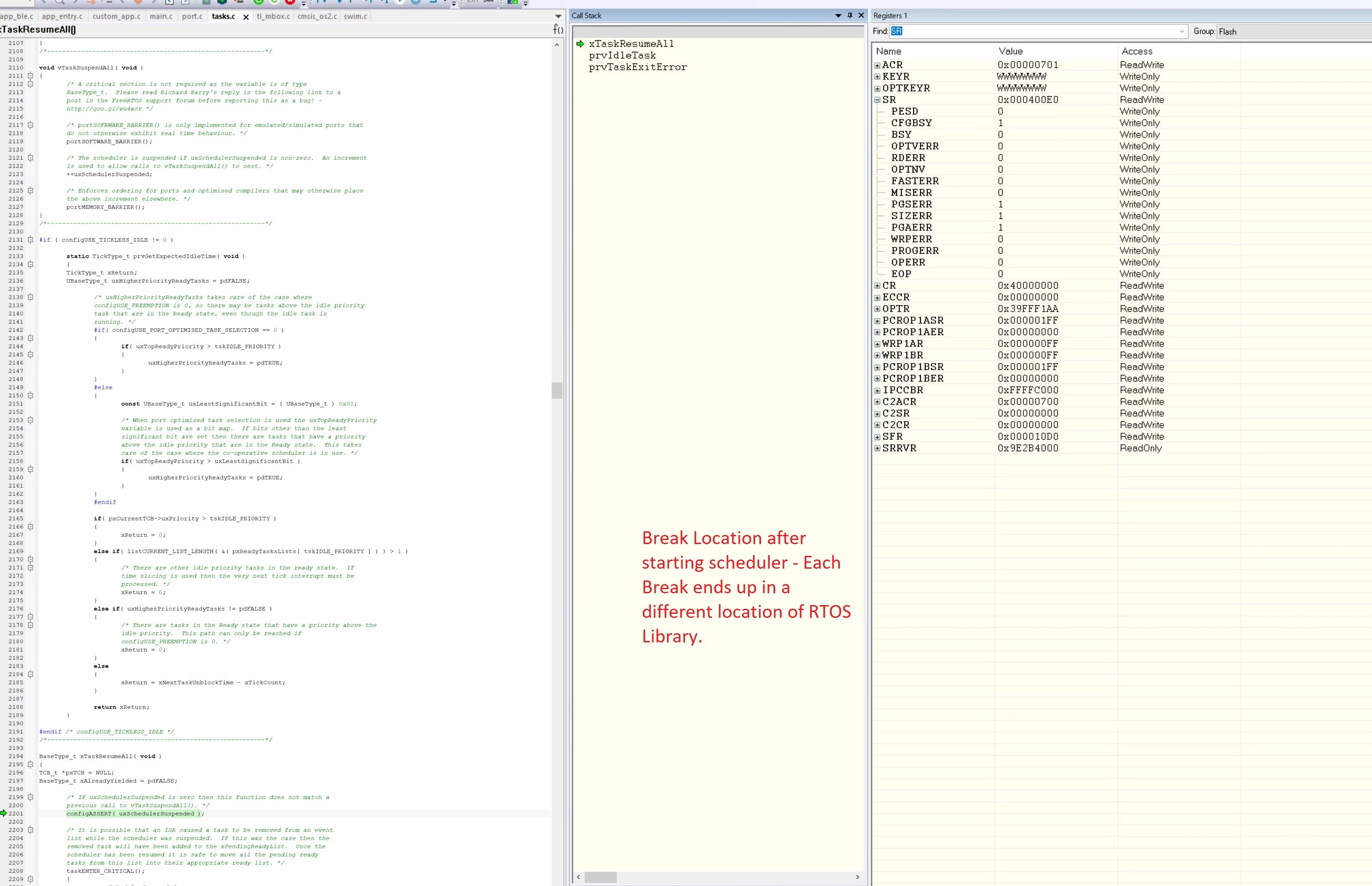

Amogh
AmoghAuthor
Apr 12, 2022 9:46 PM UTC

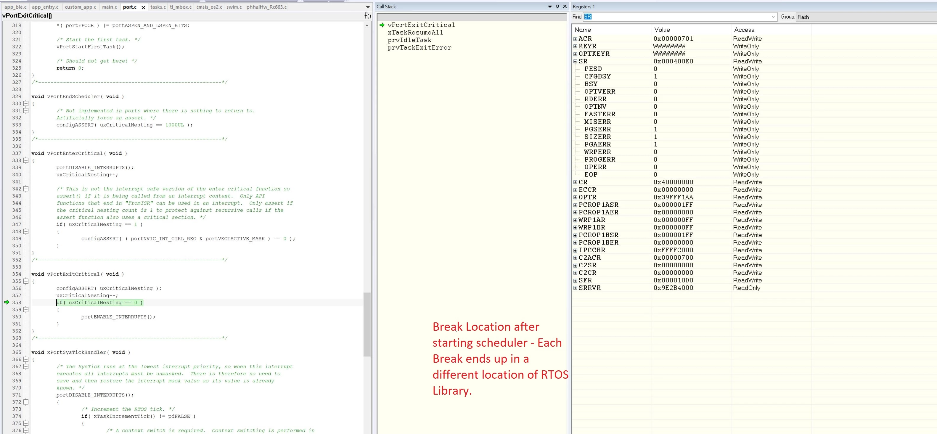

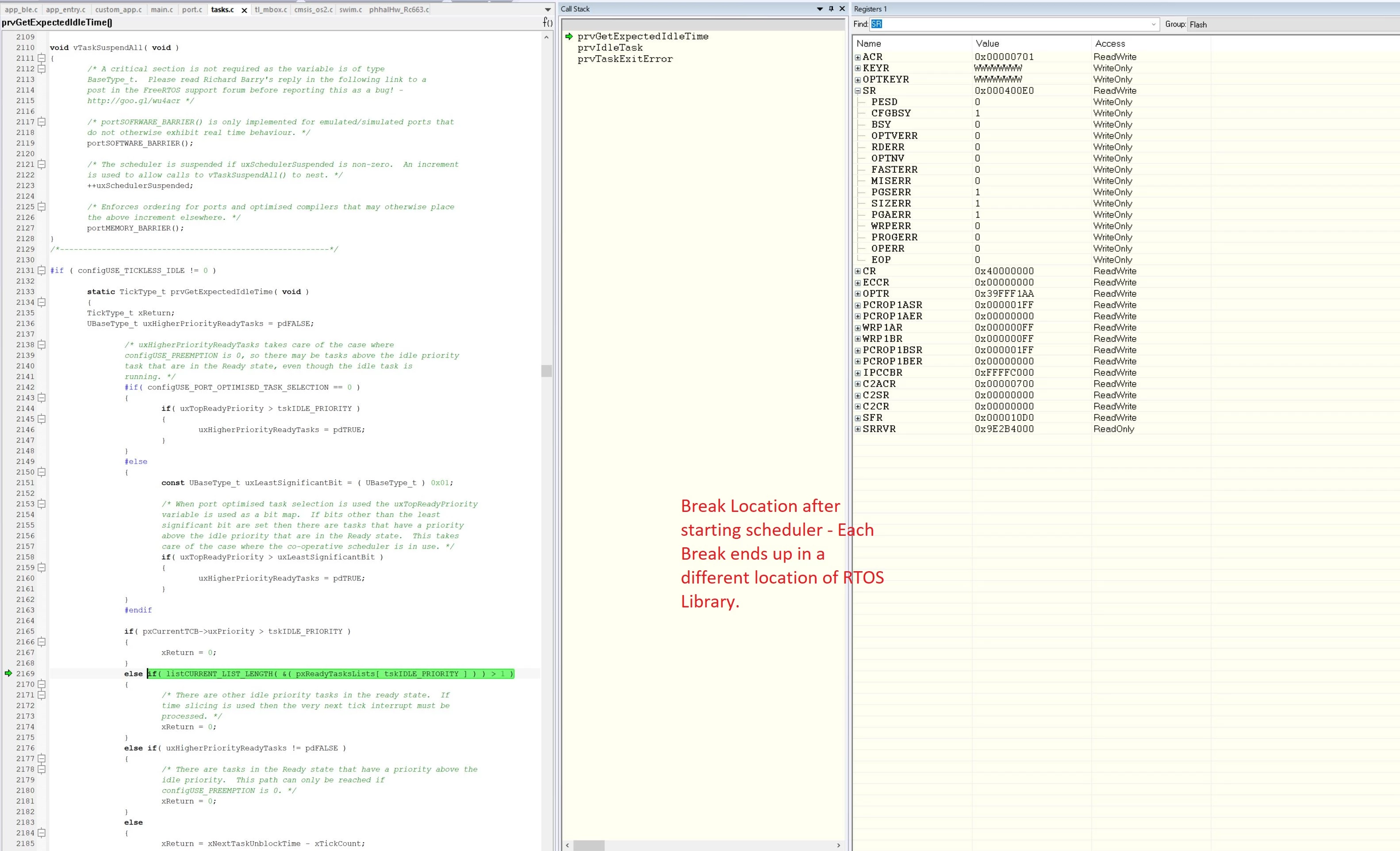

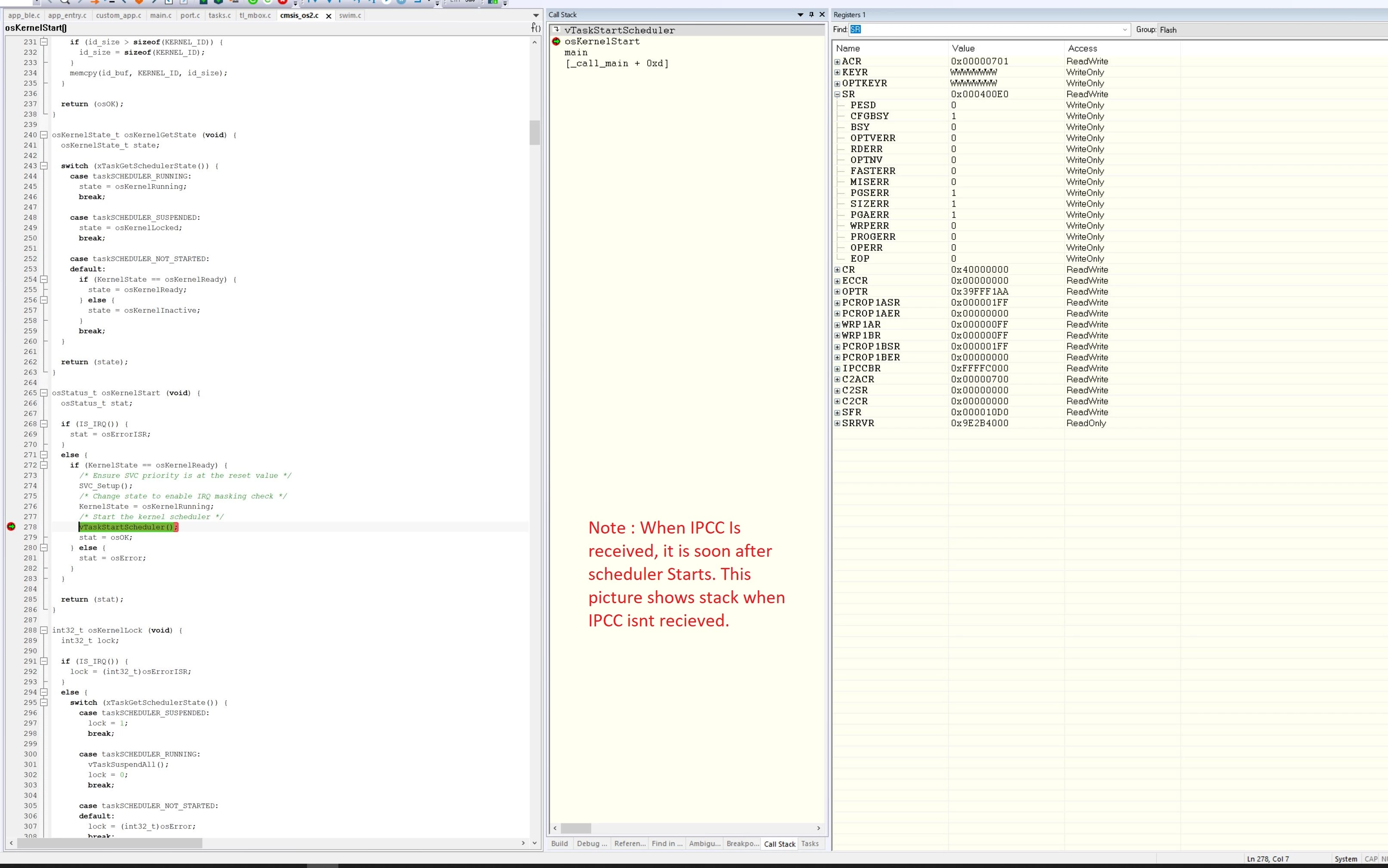

  • We have 1.13.3 as our BLE Stack.

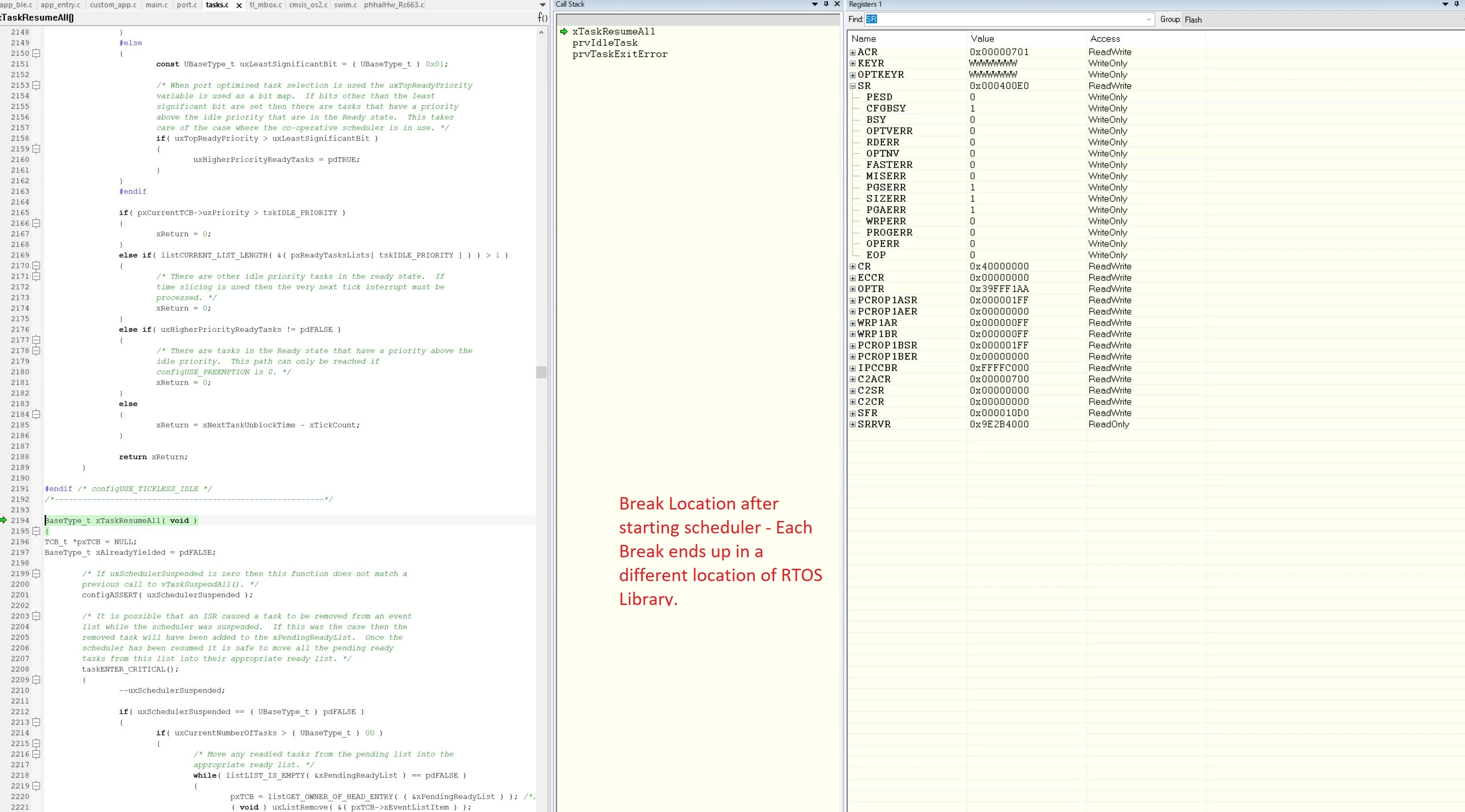

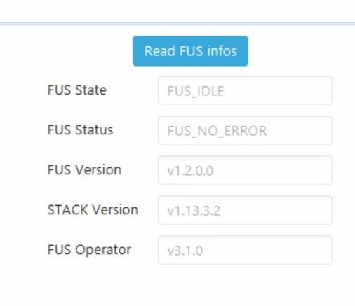

  • Can you please elaborate, on how did you deduce CPU2 experienced hardfault? Please see attached pictures that show CPU is somewhere in RTOS Scheduler - (waiting for something..?)
Screenshots shows the Flash Status Bytes before callback is attached, and after IPCC is initialized =>
Screenshots shows where the CPU is Spending its time When IPCC is Expected..
0693W00000LxmmtQAB.jpg0693W00000LxmjWQAR.jpg0693W00000LxmwPQAR.jpg0693W00000LxmvmQAB.jpg
  • in CubeMX : SYS : we have TIM16 as TimeBase Source.
  • Sorry about a mistake, but I should have written NONE instead of LOW. We have to turn OPTIMIZATIONS to NONE to ensure IAR can build in RELEASE Mode, and BLE Works. But again, its intermittent, i.e. when we make small changes, BLE IPCC stops.
Thanks

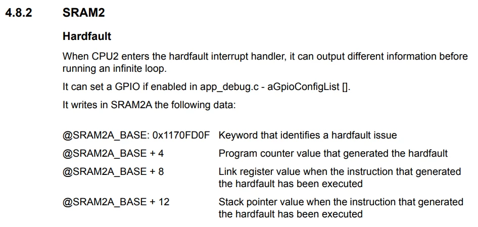

At the address 0x20030000, you have the hardfault keyword according to AN5289:
0693W00000Lxp6HQAR.pngAnd with flash register, we can see that flash is in error maybe causes by writing data at address 0x00000000 of the flash (e.g null pointer).

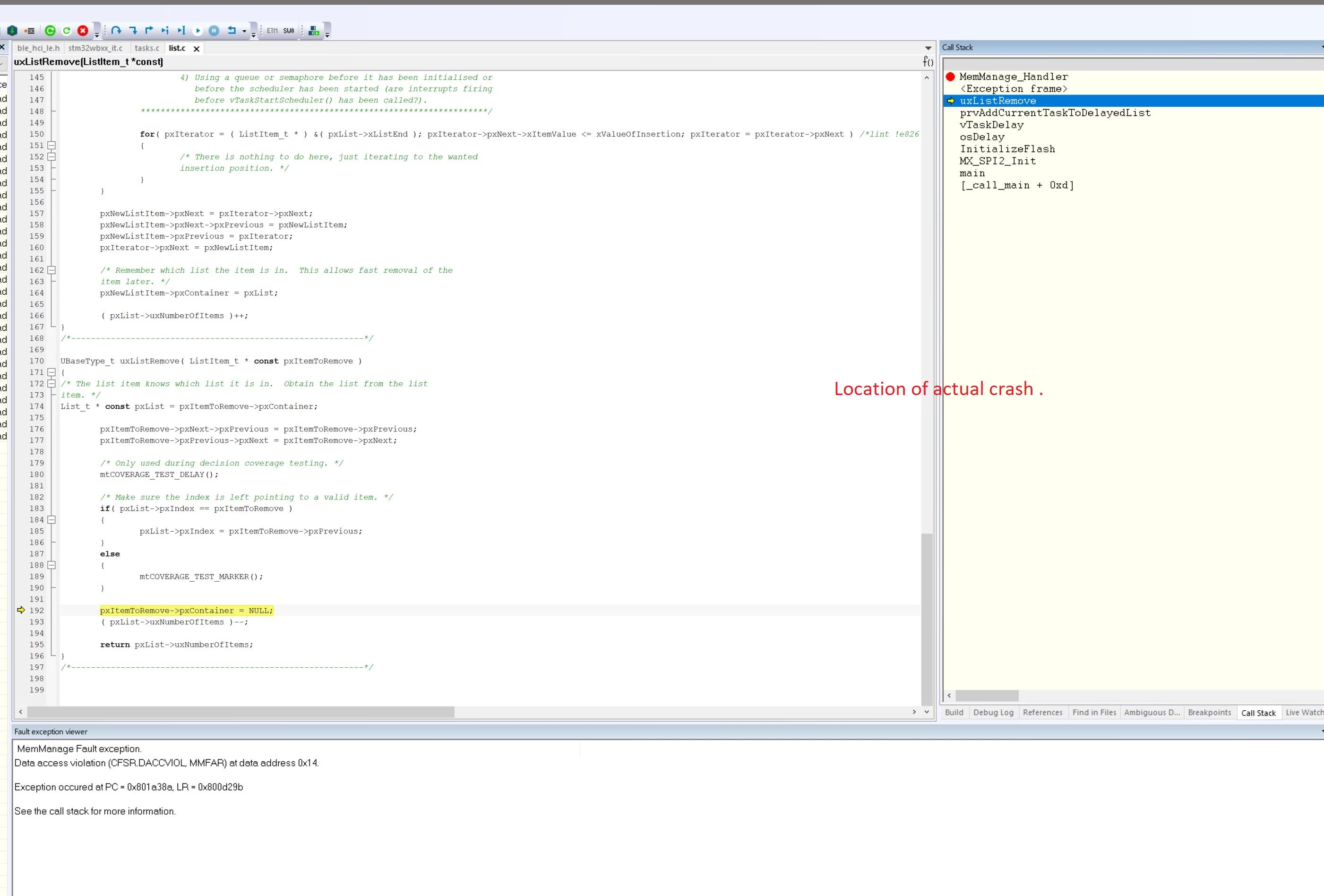

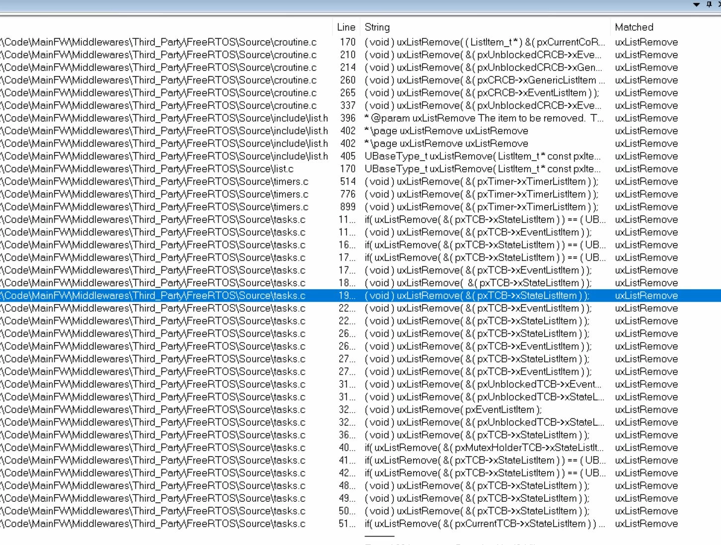

Amogh

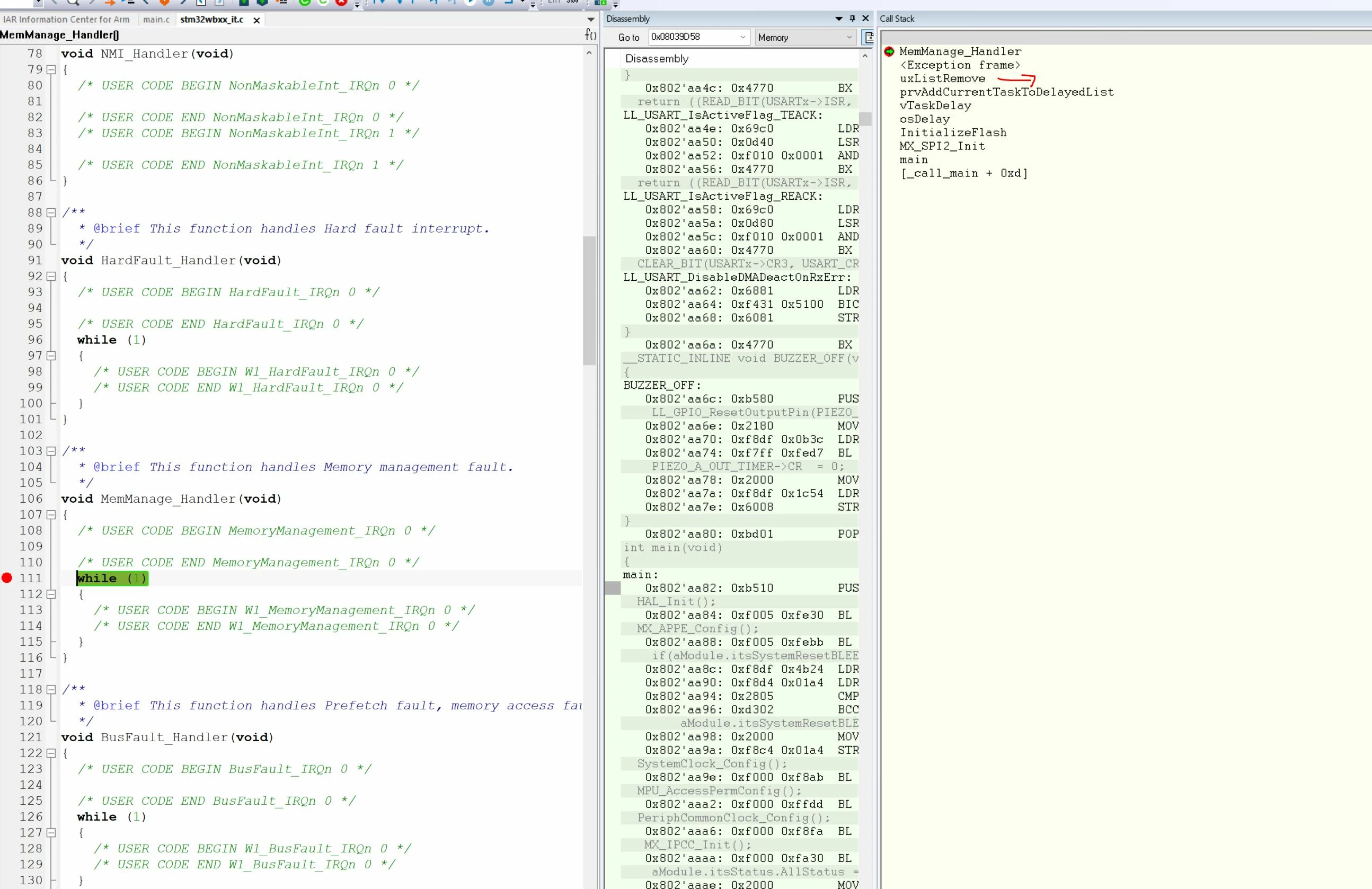

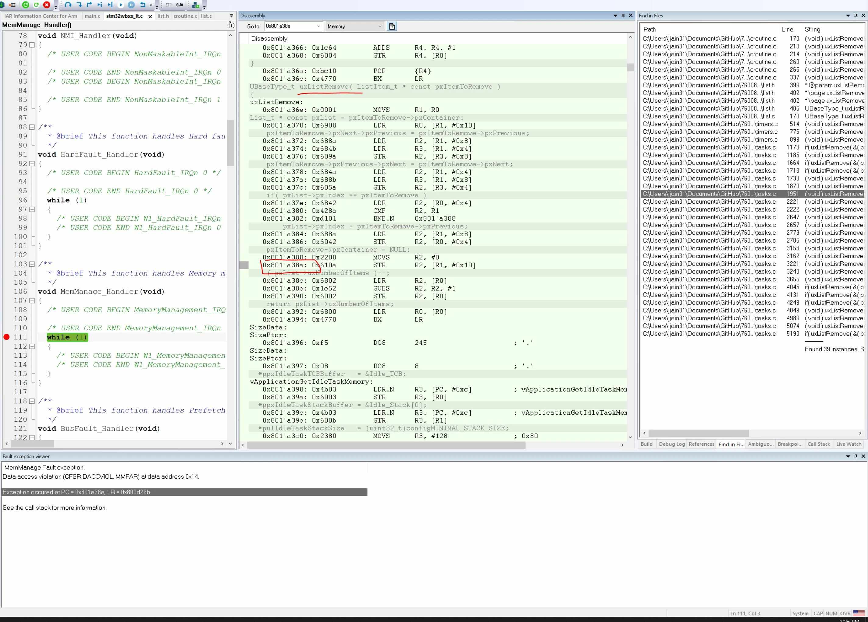

AmoghAuthor
Apr 13, 2022 6:32 PM UTC
Thanks for such a detailed response.

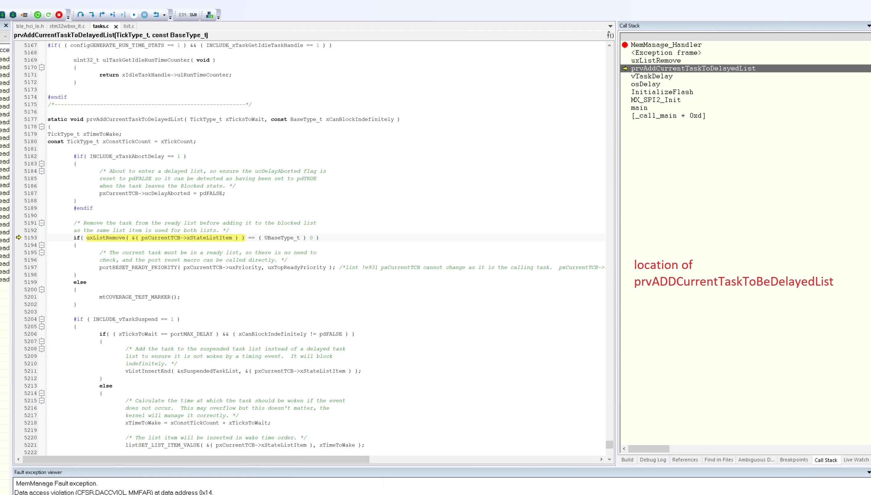

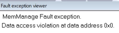

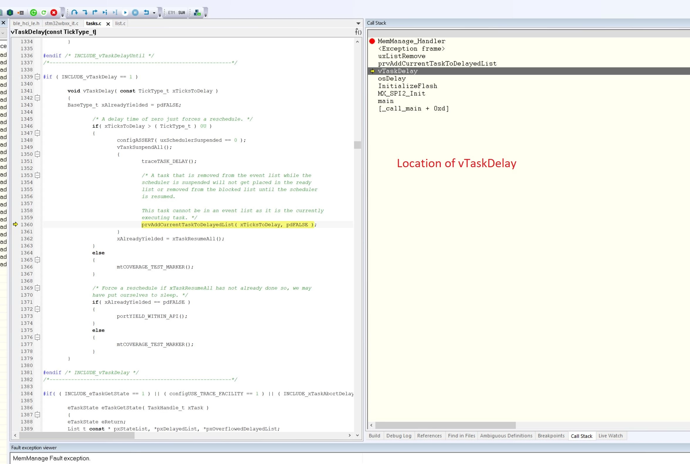

I followed your advise and attached below are the screenshots for
  1. Stack at Hardfault Failure
  2. Locations where the function causing failure is present.
  3. Instruction(@PC) which is causing the failure
I am assuming since uxListRemove() is the last function on the stack, and since NULL node is being removed, a crash happens. Would I be correct?
I am still looking into the exact location in the file where this function is called.
0693W00000Lxub5QAB.jpgThanks
