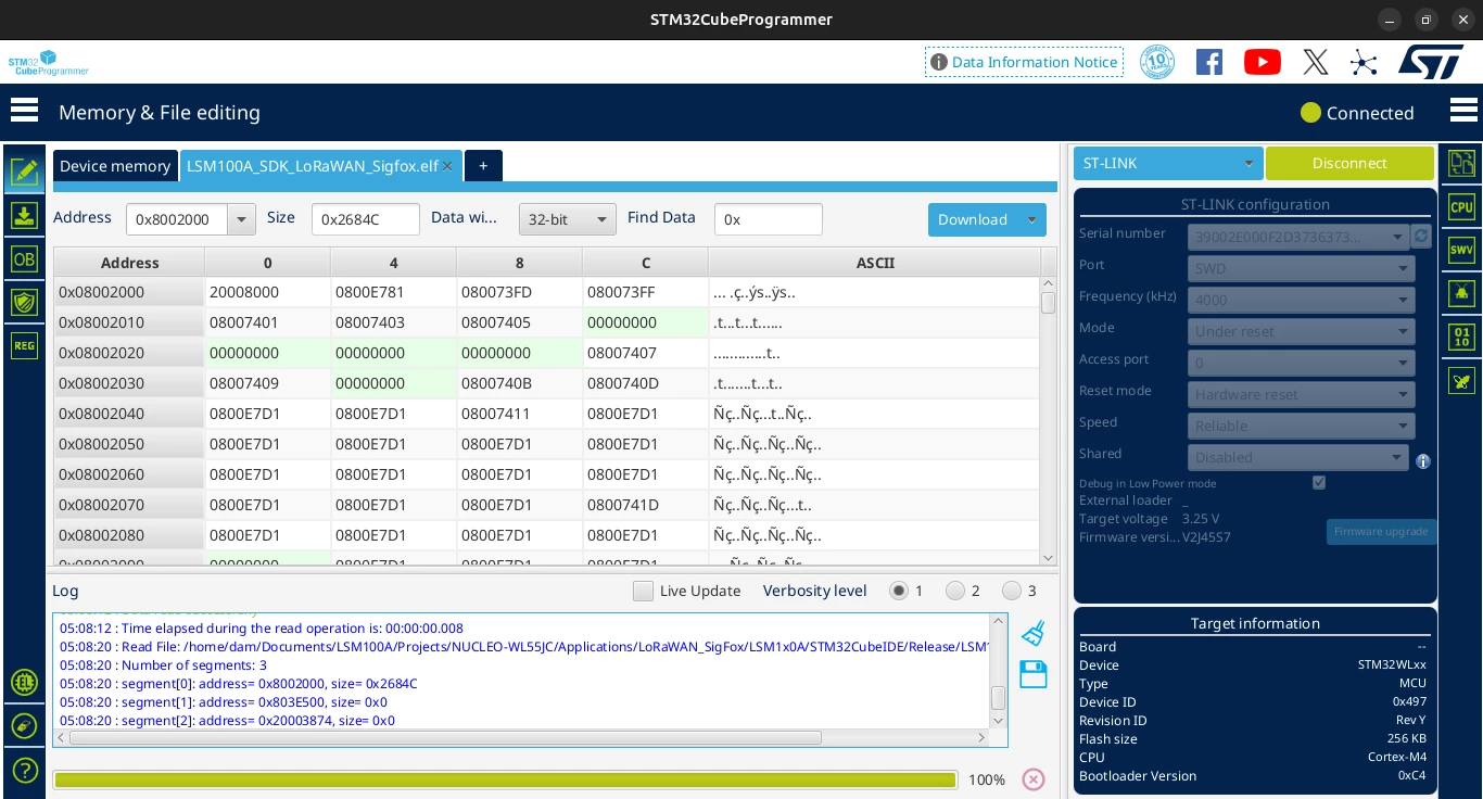

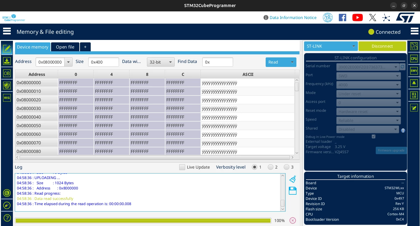

i try to program LSM100A ( STM32WLE5CC ) .
i can connect but can't program an elf file : error fail to erase memory, then cube programmer crashed.
thank you for support

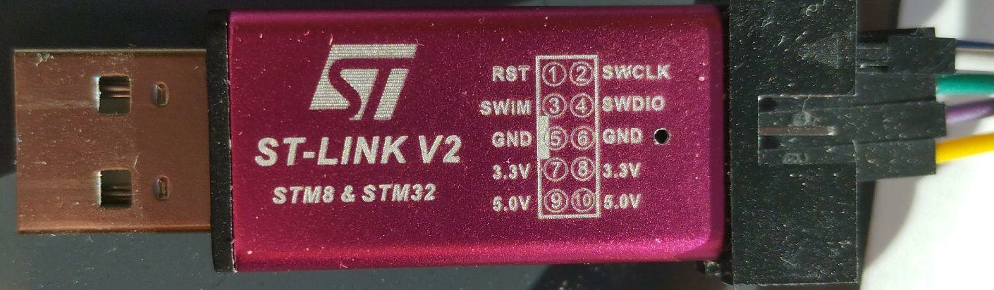

Here's the STlink I'm using with STM32F103 also.
STTwo-32
STTwo-32Best answer
Jan 25, 2025 12:38 PM UTC
It semes that you are using a clone ST-LINK V2, so we can’t guarantee that it will work fine. Please ensure that you are using a genuine ST-LINK V2 to guarantee that it will work fine. More details are available in this article.
Best Regards.
STTwo-32
