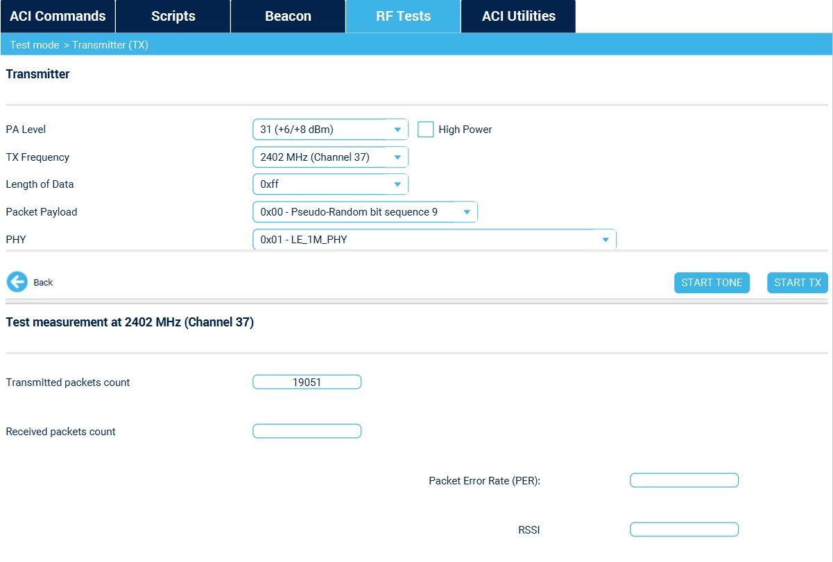

i'm using STM32WB05KZ (nucleo board) : Nucleo-WB05KZ with STM32CubemonitorRF
Please why here i can't select  "Get RSSI" , it's locked ?
and other question how can i modifie the outpout power (TX) of the antenna ( dBm) ?
thank you

Hello @ljm
The Get RSSI option is locked due to the Firmware implementation on the STM32WB0, the ACI_HAL_READ_RSSI command is not supported.
For the second question, if you are testing on a transmitter, you can set the PA Level you want here:
Best Regards.

hello
thanks for replying.
for "Get RSSI" means there is no solution to get the RSSI value ?
i do the some in mode transmission, i get the number of packets but there is no value for the rssi :
thanks

Mar 12, 2025 10:34 AM UTC
For the STM32WB0, you can't get the RSSI using the STM32CubeMonitorRF.
