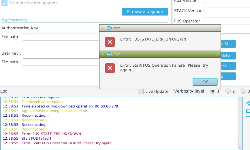

Problem loading stack on a nucleo STM32WB55
It's a board I've been using for a while, and I'm struggling loading a new stack onto it.
Here are the steps I've executed:
1/ powercycle
2/ start FUS
3/ delete image
4/ powercycle
5/ start FUS
6/ get FUS info: FUS_IDLE | FUD_NO_ERROR | Version=1.1.1.0 | stackversion=1.13.3.2 | FUS opeatorver = 3.1.0
7/ erase memory to load the stack (stack full basic v1.13.3.2, address @0x080D0000)
8/ firmware upgrade of the stack (with verify download enabled, and first install (tested without too))
9/ ERR_IMG_NOT_FOUND.
The weird part is that after a firmware delete and a powercycle, the fus still report the current stack version being v1.13.3.2. However, after checking with a getfwinfo, I get the stack_type == 0. And the SFSA is 0xF4, so only the FUS is protected, leaving the whole Flash writable for the image (which has been verified!)
Can you advise?

OTOMA.2
OTOMA.2Author
May 13, 2022 10:41 AM UTC
Dear Remy,
I've read the page, and while upgrading the FUS, it feils on step 3.1.2 Start FUS:
here is a capture of the error withint the STM32CubeProgrammer 2.10.0
(i've tried several times as specified with board reconnection)
Best regards,

OTOMA.2
OTOMA.2Author
May 20, 2022 1:58 PM UTC
Wrapping up on that problem, after realising the FUS1.1.1 faulted and delegated the boot below the secure flash limit, I've been able to disable ESE and reload a FUS to make the board work again.
After trying on a second virgin board, I succeeded in performing my IAP stack loading through FUS 1.2.0 without the flitch encountered with the FUS 1.1.1.
Cheers, and thanks everyone for your comments!
