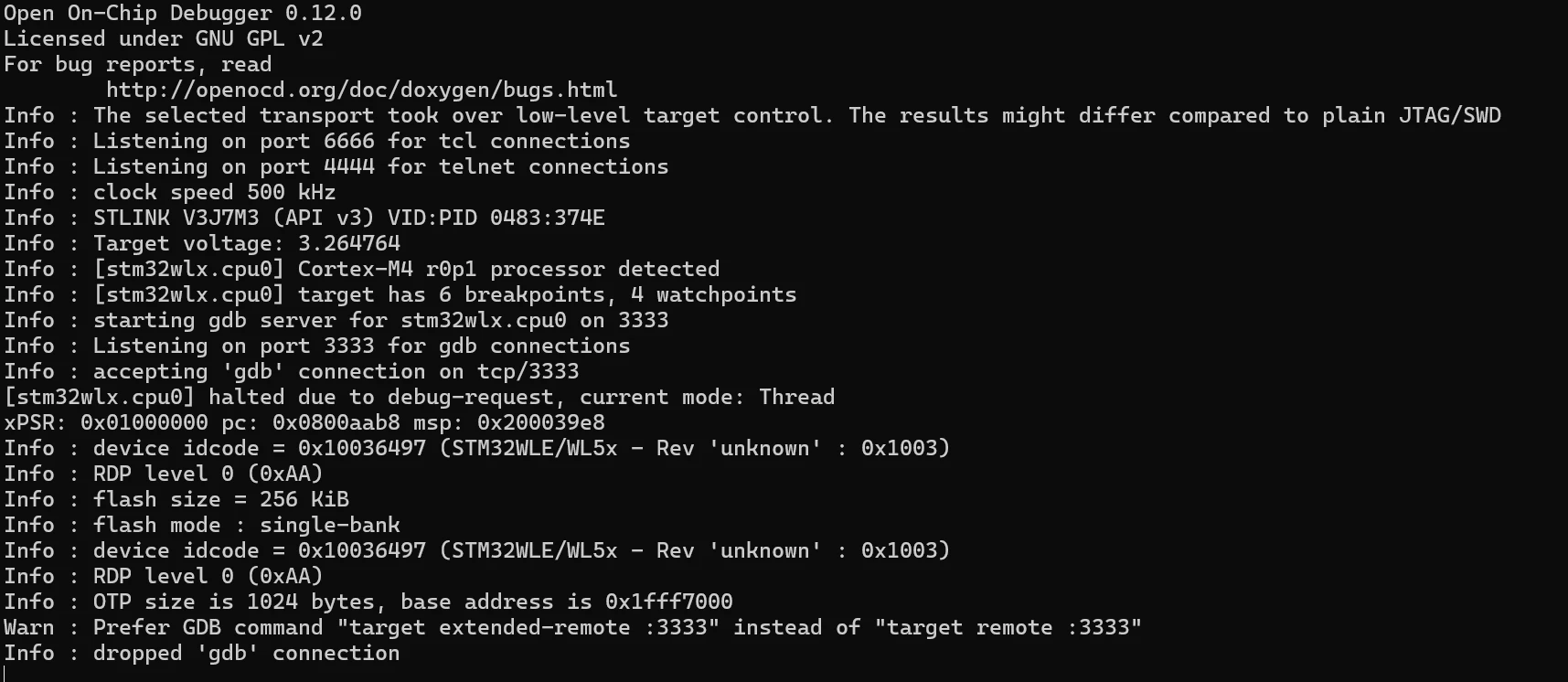

for a remote dev environment I need to connect to the on-board stlink remotely.
when trying to connect I get this error:
I already tried this forum solution
https://community.st.com/t5/stm32-mcus-boards-and-hardware/how-to-deal-wirh-could-not-verify-st-device/td-p/234230
but the issue persists. Any hint?

I am using the last update from repository for openocd on my raspberry pi.
The st-link I am trying to connect to is the embedded one on the WL55 nucleo board.

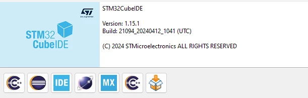

CubeIDE is fully updated
I also changed the expected-id in stm32wlx.cfg from openocd as suggeste in the linked post.
any other hint?
any other hint I should check?
